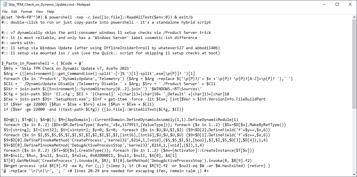

    Not all updates may fail, but users who run into the issue may wonder what they can do about it. Is there a way to bypass the minimum requirements again to get the failing updates to install? Yes, indeed there is.
    Here is what you need to do:
    1. Open the GitHub project website of the MediaCreationTool.bat utility.
    2. Select Code > Download ZIP.
    3. Extract the ZIP on the target system.
    4. Open the folder bypass11.
    5. Right-click on Skip_TPM_Check_on_Dynamic_Update.cmd and select run as administrator.
      1. If "Windows protected your PC" is displayed, select More info > Run anyway.
    6. Confirm the UAC prompt that is displayed.
    A command prompt window opens that confirms that the bypass has been installed on the system. You may run the script again at any time to remove the bypass again from the system.
    A comment at the top of the file reveals that it uses a /Product Server trick for the bypass.
    v7 dynamically skips the anti-consumer windows 11 setup checks via /Product Server trick
    it is most reliable, and only has a 'Windows Server' label cosmetic-ish difference
    It is advised to create a backup of the system before you make any change to it, including this one. You may load the cmd file in a plain text editor to look at the code and make sure that it is legitimate.

    While the main script of this open-source project is the 'MediaCreationTool.bat' used to create Windows ISOs, it also includes a script named 'Skip_TPM_Check_on_Dynamic_Update.cmd,' which configures the device to bypass compatible hardware checks.
    When executed on a Windows 10 or Windows 11 device, the Skip_TPM_Check_on_Dynamic_Update.cmd script will perform a variety of tasks, including:
    Create the 'AllowUpgradesWithUnsupportedTPMOrCPU' value under the HKEY_LOCAL_MACHINE\SYSTEM\Setup\MoSetup Registry key and set it to 1.
    Registers a WMI event subscription named 'Skip TPM Check on Dynamic Update' that deletes the 'C:\$WINDOWS.~BT\appraiserres.dll' file when the vdsldr.exe executable is launched during Windows 11 setup.
    It should be noted that the created WMI event subscription will remain in effect until you run the Skip_TPM_Check_on_Dynamic_Update.cmd script again, which will cause the event subscriptions to be deleted. You can do this after installing or upgrading Windows 11.
