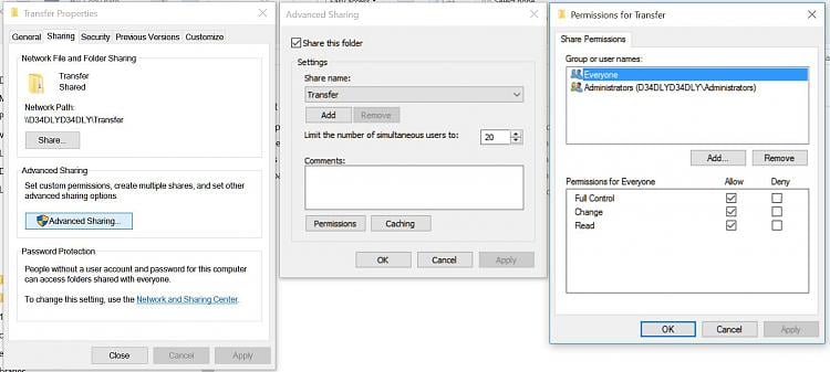

    I have a new Windows 10 Home computer and I've selected a folder and shared it. I've added Everyone to the Share Permissions list with Full Control.
    Windows 11 PC asking for credentials to access file sharing PC no matter what I do 485956594t-win-10-pc-accessing-win-10-everyone-share-prompted-credentials-shared-folder-settings.jpg

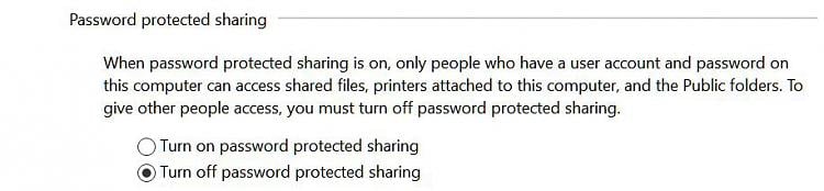

    I've selected "Turn off password protected sharing" in the Advance Sharing Center.

    Here is the solution for this issue :
    1 Right click on the folder that you want to share
    2. Go to Properties
    3. Go to Security Tab then click Edit on group and usernames
    4. Click Add and on the user and group window click advance
    5. Click Find Now and look for Everyone on the Search results, Click OK to close the window and OK again
    6. Give the control you need for Everyone and click "OK"
    That should make that folder accessible without prompting for windows credentials Windows 11 PC asking for credentials to access file sharing PC no matter what I do :)
