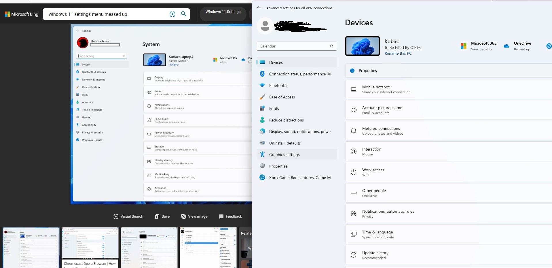

    Windows 11 - Settings menu is messed up wrong names, wrong sections  even wifi and... 7413f659-cdd7-4e6a-93b9-8280ab8aae50?upload=true.jpg
    Hello, I installed windows 11 Pro and when I finished the initial setup, Settings menu options are messed up. On the picture, you can see the difference. The left one is image I found on the Internet (like how Windows 11 Settings is supposed to look like) and on the right is my Settings menu. Instead of System, it says Devices. Instead of Network, it says Bluetooth. Why is Settings like this? Thank you for your answers.
    Nikola Obradovic, Apr 5, 2023

    Hi Nikola,
    I'm Christine, a Windows user like you. I'll do my best to help you.
    Looks like you're having issue with your Windows with your Settings options. Let me help you with that. Please follow the steps below:
    Method 1
    Let's run the repair command for Windows Settings and Store
    Please click Start menu and type Powershell, right click on it and choose Powershell(admin), copy and paste the command below:
    Get-AppXPackage | Foreach {Add-AppxPackage -DisableDevelopmentMode -Register "$($_.InstallLocation)\AppXManifest.xml"}
    Then hit Enter, once the process is finished, please restart the PC and check.

    Thank you for your answer, the first option solved the issue Windows 11 - Settings menu is messed up wrong names, wrong sections  even wifi and... :) But I am still wondering how windows managed to be messed up like that, it was just installed...
