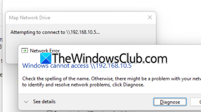

    Windows 11 SMB Client cannot connect to SMB share
    Windows 11 SMB Client cannot connect to SMB share network-error.png ​
    Windows 11 sometimes fails to connect to SMB shares that are perfectly accessible. You see Windows cannot access \share or, when using the command line, System Error 53 – “Network path not found.” This happens even when other devices (Mac, iOS, Windows 10) connect to the same share without issues. In this post, we are going to […]
