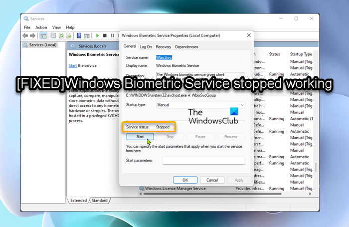

    Windows Biometric Service stopped working [Fixed]
    Windows Biometric Service stopped working [Fixed] Windows-Biometric-Service-stopped-working.png ​
    Using biometrics (fingerprint or face) aka Windows Hello to log into your Windows 11 or Windows 10 computer can be much more convenient and secure than using a password, more so when used as part of multi-factor authentication. If you have encountered the issue whereby Windows Biometric Service has stopped working on your system, the […]
