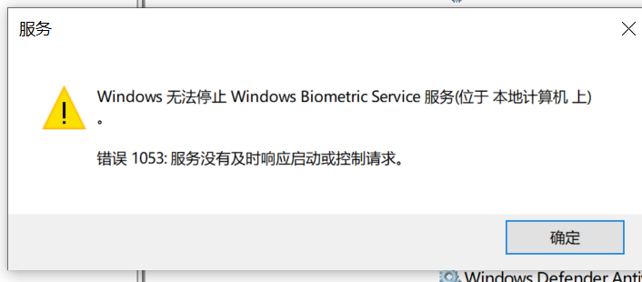

Discus and support windows biometric service in AntiVirus, Firewalls and System Security to solve the problem; [ATTACH] windows biometric service... Discussion in 'AntiVirus, Firewalls and System Security' started by Charotte Diamond, Sep 20, 2020.
  1. windows biometric service
    windows biometric service 0137777d-4b5d-44c2-b067-6113fe70d426?upload=true.png
  2. Why Is Windows Biometric Services Taking So Much CPU?
    When I start my laptop, it comes up just fine. But then Windows Biometric Services starts taking 18% of the CPU and stays there until I end the task manually. I have reloaded the Biometric driver, but the issue persists. Any suggestions are welcome!
    Thanks
