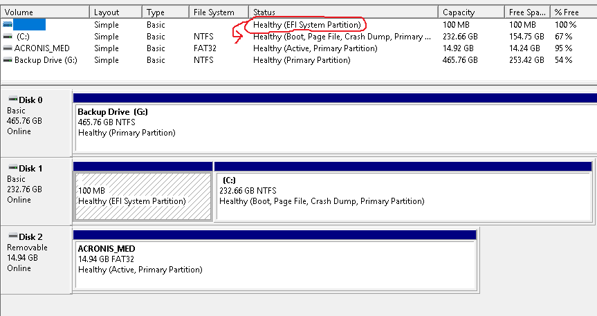

  4. Windows boot/efi/recovery partitions are not on the C drive
    Merge EFI System partition with Windows/Main (C) partition
    My Windows 10 installation created a separate EFI partition which contains the boot files. See picture:
    Windows boot/efi/recovery partitions are not on the C drive 4be8c261-15a5-4a5a-a12b-5a4704b21a80.png
    What I would like to do is merge the boot files from the EFI partition onto the main (C drive) partition so I can remove that extra partition. I cannot find any documentation on how to do this.
    Although it says the boot files are on the C partition already, I know they are actually on the EFI partition because when you look into the EFI partition, I can see them - I'm not sure why this view is saying that the boot files are on the C partition.
    At any rate, I want it all to be a single partition.
    There is lots of documentation which talks about moving EFI boot files OFF the main (C drive) partition to a new/different partition, but nothing I could find describes the merge that I'm trying to do.
    Please help.
    Thanks
    Bob
