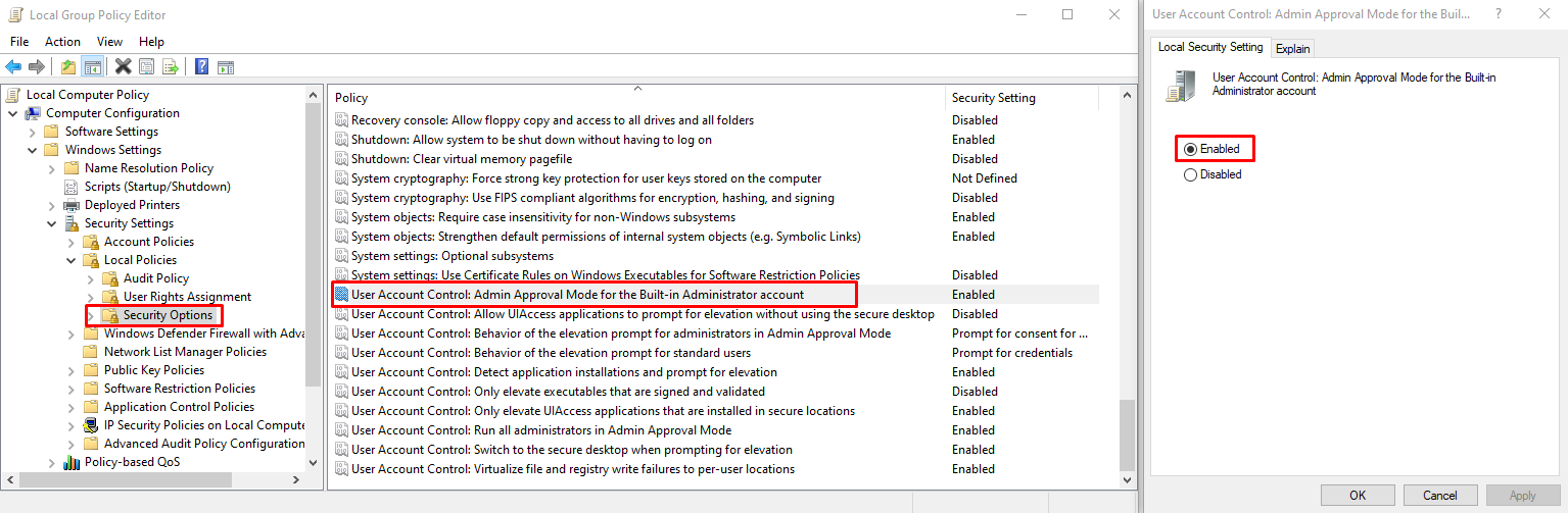

  4. KD12 Win User
    Windows "Change Adapter Option's" not opening via "Settings" menu
    Change Adapter Options Wont Open
    Try this:
    1. Open run (Windows Key + R) > type gpedit.msc > Open
    2. In the navigation pane on the left, expand Computer Configuration > Windows Settings >
      Security Settings > Local Policies
    3. Select Security Options
    4. On the right pane, scroll down and double click User Account Control: Admin Approval Mode for the Built-in Administrator account
    5. Select Enabled
    6. Apply > OK and then Restart Windows
    Change Adapter Options should be working now.
    Windows "Change Adapter Option's" not opening via "Settings" menu 9ea586f7-e660-4ebc-bffe-ebf61f8e39f9?upload=true.png
