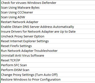

    About the time of the last Windows 10 update, my PC lost its reliable WiFi connectivity to the internet. Troubleshooting yielded the error message in the title of this post.
    Researching the "try this" approaches to fix the problem, I have completed the following:
    Windows could not automatically detect the network’s proxy server settings cdc6eac9-c3a5-44f5-a558-f02998bbb148?upload=true.jpg
    Some are listed but couldn't be done --- those having to do with an Ethernet connection between the PC and the router. I am strictly WiFi.
    All other WiFi devices in the house --- phones, iPads, laptops, streaming boxes, etc. work fine.
    Are there other things to try, or is my PC basically been trashed by Windows 10?
