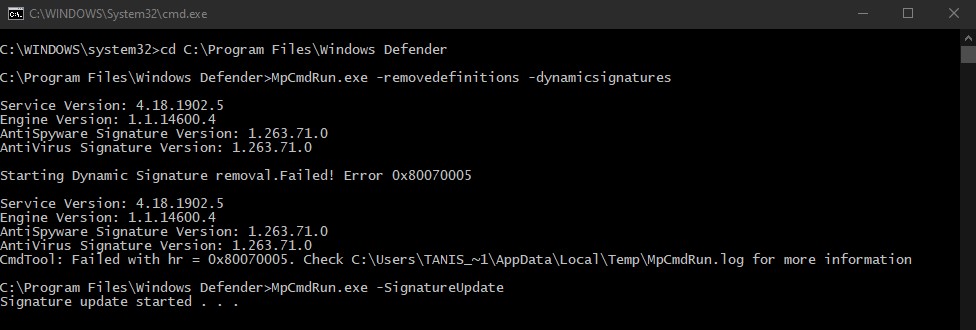

    I tried the solutions given here. I tried triggering an update using this batch file:
    cd %ProgramFiles%\Windows Defender
    MpCmdRun.exe -removedefinitions -dynamicsignatures
    MpCmdRun.exe -SignatureUpdate
    and got error 0x80070005:
    Windows Defender not working or updating 0d38ddcb-1d5d-4606-8299-56717db0acd1?upload=true.jpg
