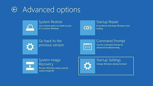

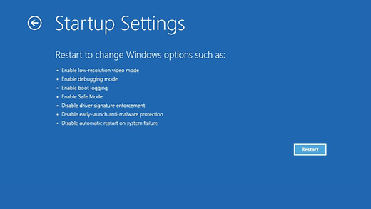

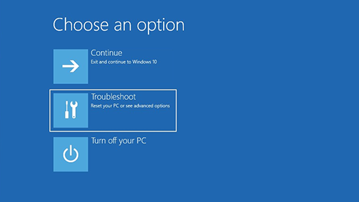

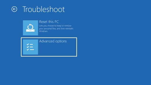

    Now that you are in winRE, you will follow these steps to take you to safe mode:
    • On the Choose an option screen, select Troubleshoot > Advanced options > Startup Settings > Restart.
      Windows freezes at spinning dots + windows logo screen. Can't access winRE. If I restart... 4483158_en_1.png
      Windows freezes at spinning dots + windows logo screen. Can't access winRE. If I restart... 4483144_en_2.png
      Windows freezes at spinning dots + windows logo screen. Can't access winRE. If I restart... 4483154_en_1.png
      Windows freezes at spinning dots + windows logo screen. Can't access winRE. If I restart... 4483155_en_1.png
    • After your device restarts, you'll see a list of options. Select option 5 from the list or press F5 for Safe Mode with Networking.
