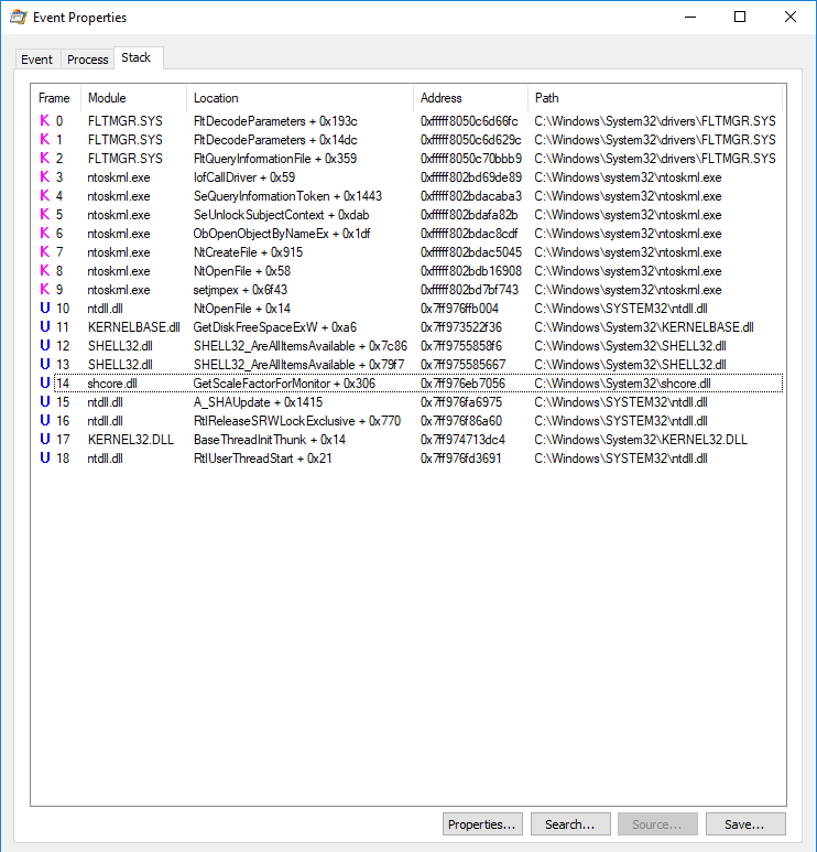

    I've built a new high-end gaming rig and have noticed that every 10min, explorer.exe would spin up all my secondary HDD's.
    When it does this, windows freezes, as does anything I am running, such as a video game, video, browser etc.
    This is extremely frustrating, and causes wear and tear on the drives unnecessarily.
    Process Monitor shows it is explorer.exe, doing a "CreateFile", "QueryFullSizeInformationVolume", and "CloseFile" action on each drive, exactly every 10minutes. How can I disable this? I don't want to have to unplug the drives and use them externally.
    Never had this problem in windows 7, which I just updated from.
    Windows and other running applications are on a SSD, Drives C and I. The rest of the drives are mechanical secondary drives and are for storing information only. Screenshot below has C and I Drives filtered out.
    Indexing is disabled for the secondary drives. Page file is on the SSD. No antivirus or malware scanning programs installed other than the windows defender. Have already done checks for viruses and malware though, and the PC is clean.
    How can I disable this???
    Cheers
    Windows freezing every 10min, for a few seconds, while secondary HDD's are spun up. b36f550b-88e4-4484-97b5-aaa5fcd40440?upload=true.png Windows freezing every 10min, for a few seconds, while secondary HDD's are spun up. 6cc25cfa-d644-4393-95e3-e8797f356718?upload=true.png
