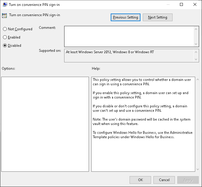

  4. Windows Hello and convenience key PIN sign-in Issues after update.
    Disabling "Turn on convenience key PIN sign-in" doesn't work.
    Windows 10
    I used gpedit.msc to update the computer's turn on convenience key PIN sign-on from "Not Configured" to "Disabled" but disabling it didn't work. I expected it to override all accounts' abilities to use pins. I tested that a user could still sign on with
    a pin. I even rebooted and verified setting was still "Disabled" when I logged back in.
    This is a security problem because pins are easier to figure out than good passwords. I also figured out kids in the family are using this to get around family time limits by going into other peoples' accounts, so it isn't just hypothetical
    Computer Configuration > Administrative Templates > Systems > Logon > Turn
    Expected behavior: Changing to "Disabled" prevents users from logging on with pin.
    Actual behavior: Changing to "Disabled' has no effect.
    I also don't want to remove pins for certain family members from the Microsoft account. I just want to disable it from being used on this computer.
