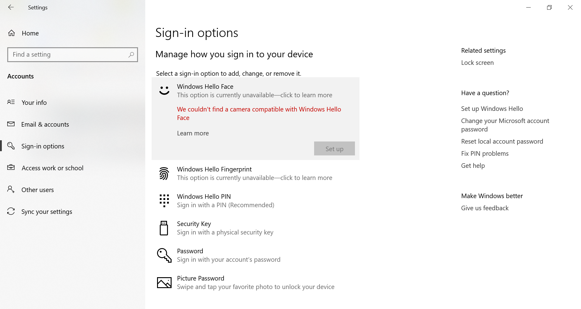

Discus and support Windows Hello doesn't work on my Surface 6 Pro in Windows Hello & Lockscreen to solve the problem; Hi, I tried all fixes ways to setup windows hello on my Surface 6 Pro but gives me always: "We couldn't find a camera compatible with Windows Hello... Discussion in 'Windows Hello & Lockscreen' started by wgohar, Oct 21, 2019.
  1. wgohar Win User
    "We couldn't find a camera compatible with Windows Hello face" Windows Hello doesn't work on my Surface 6 Pro 53543032-95c8-4a1a-be75-21c21e38289a?upload=true.png

  4. Nikhar_K Win User
    Face ID not working in Surface Pro 6
    We understand that you are unable to use the Face ID on your Surface Pro 6, we will look into this for you. We would like to know if you are aware of any changes on the computer recently.
    However, I suggest you to refer the steps mentioned below and check if that helps in resolving the issue:
    Method 1: Resetting Windows Hello Biometric Database
    You can try resetting the Windows Hello Biometric Database and check if that helps. Please follow the steps mentioned below:
    1. Press Windows key + R, to open
      Run
      dialog box.
    2. Type services.msc and click on
      OK
    3. Look for Windows Biometric Service, double click on it and click on
      Stop.
    4. Now, go to C:\Windows\System32\WinBioDatabase, take a backup of all the files inside the
      WinBioDatabase folder.
    5. After taking a backup of the files, delete all the files.
    6. Now, open Services by following step 1 and 2, and restart the
      Windows Biometric Service.
    7. Go to Start >> Settings >> Accounts >> Sign-in options and register the Face data again.
    Method 2: Installing Windows Hello Face Driver
    If method 1 didn’t help. You can try to reinstalling the Windows Hello Face Driver. Follow the steps mentioned below:
    1. Press Windows key + E, to open
      File Explorer
    2. Navigate to C:\Windows\System32\WinBioPlugIns\FaceDriver
    3. Look for HelloFace.inf and
      HelloFaceMigration.inf
      file, right click on each file and select
      Install
    4. Restart the computer.
    For additional information, you may also refer the article
    Troubleshoot problems with Windows Hello on Surface
    Let us know how it goes.
