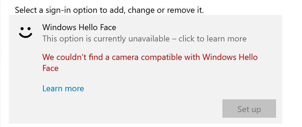

    Good Afternoon,
    i bought my new windows 10 laptop before 2 weeks.But i cant setup windows hello face sign in option in my windows 10 hp pavilion x360 laptop.It shows that there is no compatible device but there is a built in HD webcam in my laptop and it works properly without any issue.All sign options works but this hello face alone shows this problem.kindly acknowledge me if i can myself do anything in my laptop to make it work.
    Thank you

  3. Nikhar_K Win User
    Windows Hello Face Sign In Option Unavailable
    I appreciate the efforts taken by you in resolving the issue. I understand that you are unable to use Windows Hello Face and PIN on your computer. I’ll certainly assist you with the issue.
    However, please let us know:
    • Are you aware of any changes made to the computer prior to this issue?
    You may want to refer the troubleshooting steps mentioned below and see if that helps:
    Reset Windows Hello Biometric Database:
    1. Press Windows key + R, to open Run dialog box.
    2. Type services.msc and click on OK.
    3. Look for Windows Biometric Service, double click on it and click on Stop.
    4. Now, go to C:\Windows\System32\WinBioDatabase, take a backup of all the files inside the WinBioDatabase folder.
    5. After taking a backup of the files, delete all the files.
    6. Now, open Services by following step 1 and 2, and restart the Windows Biometric Service.
    7. Go to Start >> Settings >> Accounts >> Sign-in options and register the Face data again.
    You may want to refer the suggestions provided by EddyK
    replied on ‎03-29-2020 in the thread
    Windows sign-in options "currently unavailable"
    Let us know the results, we will be glad to help you further.
