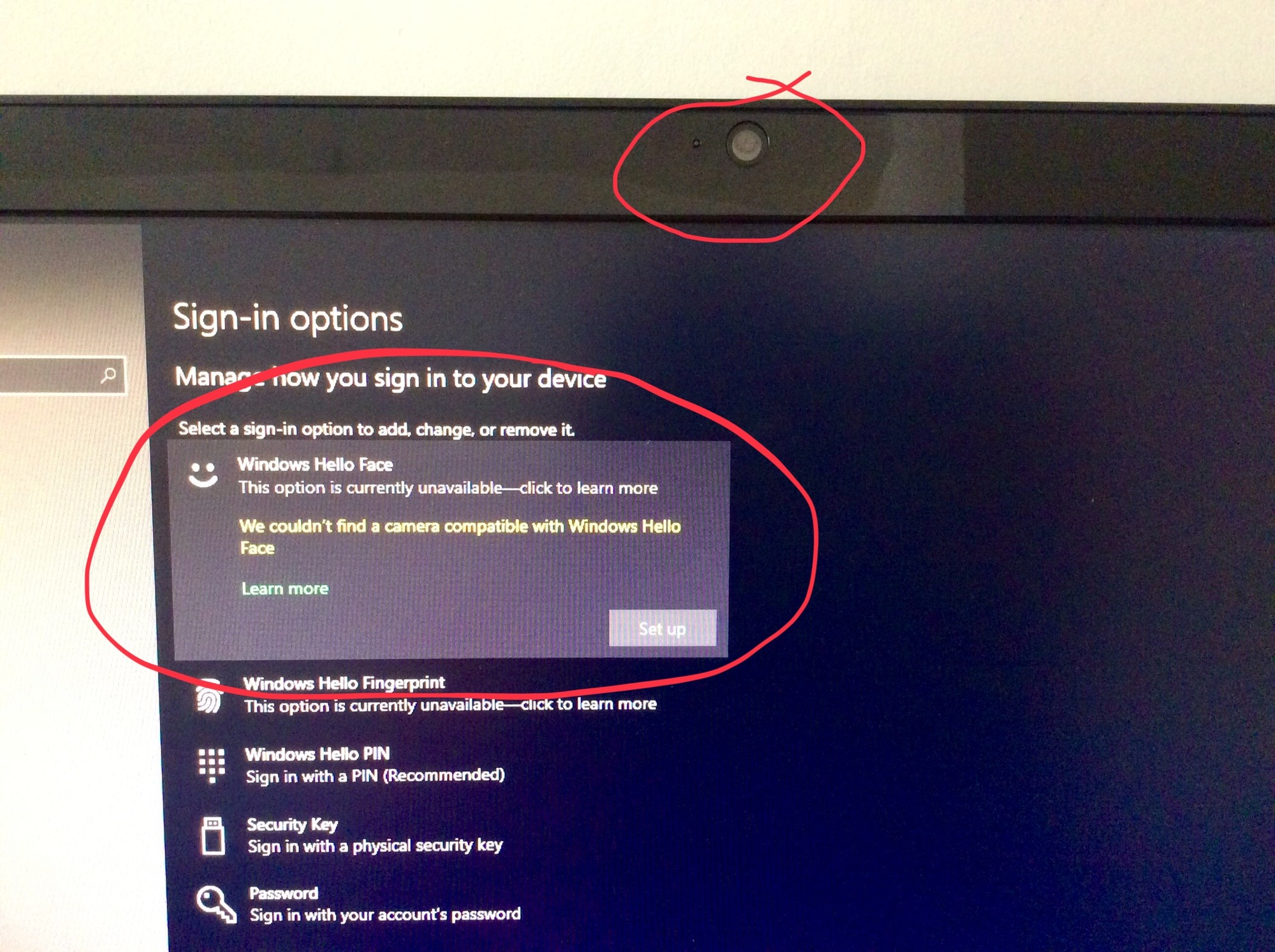

    Windows Hello Face e10bead1-c0f3-4c3c-a126-5611d9ed2f25?upload=true.jpg Hi,
    I have a PC running on windows10 home and i have an integrated webcam. I have set up hello pin, the webcam is working perfectly but i am not able to setup windows hello face. Pls help me

    Please provide us below details to assist you better,
    • How exactly you are trying to setup Windows Hello Face Recognition?
    • What is the error you are getting, while trying to setup Windows Hello Face Recognition?
    A regular webcam will not work with Windows Hello. Windows 10 features Windows Hello, which provides new ways to authentication using biometrics including facial recognition.
    Since this is essentially 3-d detection, a camera with a specialized illuminated infrared camera is required.
    I suggest you to try the below steps to setup Windows Hello Face Recognition and check if it helps.
      • Open up "Settings" and click on "Accounts," then "Sign-in options."
      • You need to set up a PIN code before you're allowed to use Windows Hello. So hit the "Add" button under "PIN" to set that up. Once you've done that the options to set up Windows Hello will unlock.
      • You'll now see which options are available to set up under Windows Hello, Since we're looking at facial unlock you'll see an option for "Face." Click on "Set Up."
      • The next screen will give you a little background on what Windows Hello is. Click on "Get started".
      • The next step could happen incredibly quickly. Position yourself so your face is in the center of the frame that appears on screen. The camera will then do what it needs to do to register your face.
      • Once you're set up you have an option that allows you to improve recognition.
      • Now, when you go back to Settings you'll have the option again to improve recognition, remove your face, a toggle to turn on unlocking your PC when it sees your face and an added security option that will require you to turn your head
        left and right for verification.
    For more information, refer to the below link:
    Biometric Facial Recognition – Windows Hello - Microsoft
    Hope this information helps. Get back to us if you have any more queries on windows.

    i have a webcam intergrated on my machine
    biometrics service running...
    windows hello face gives me this message:
    you do not have a camera on this device to use for windows hello face
    any ideas?
