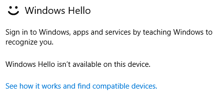

  1. Windows Hello isn't Available on this device
    I though I could work around "Windows Hello isn't Available on this device" by getting a Finger Print Scanner, at first I had to install the drivers because the Finger Print Scanner didn't come with them.
    Driver I installed for the Finger print scanner
    First one listed.
    Still wasn't working so I started messing with some settings.
    Windows Hello isn't Available on this device 7dfc3d76-c182-49e5-8dd4-c67d944a2c2c?upload=true.png
    Group Policy: Computer Configuration\Administrative Templates\System\Logon
    Windows Hello isn't Available on this device e5746195-ae41-46e4-91db-740e00c54151?upload=true.png
    Registry: Computer\HKEY_LOCAL_MACHINE\SOFTWARE\Policies\Microsoft\Windows\System
    Windows Hello isn't Available on this device 2d9709c1-00f6-4f53-a698-dd631388286b?upload=true.png
    Windows Hello isn't Available on this device 1a4c4fb8-cf05-4aa2-a558-c713b57b1919?upload=true.png
    Group Policy: Computer Configuration\Administrative Templates\Windows Components\Windows Hello for Business
    Windows Hello isn't Available on this device 73bbf03d-a8f5-43de-8933-b0a2fc7d8be7?upload=true.png
    Group Policy: Computer Configuration\Administrative Templates\Windows Components\Biometrics
    Windows Hello isn't Available on this device 86ac43c4-f3af-42a2-9ca1-f81095c0af6b?upload=true.png
    Still Doesn't work.
    However my computer does recognize it as a bio-metric device in device manager.
    Windows Hello isn't Available on this device f30d0420-1434-48a6-a930-9600db41ecc0?upload=true.png
    Can someone please give me a work around to sign in with my finger print.

  4. Windows Hello isn't Available on this device
    windows Hello states it isn't available on this device
    Hi Tom,
    Try few of the troubleshooting steps below and check if you are able to access Windows Hello.
    Step 1: I suggest you to run
    Hardware and Devices troubleshooter
    as it checks for common problems and makes sure that any new device or hardware connected to your PC is installed correctly.
    • Press Windows key from the keyboard, type
      Troubleshooting and select it.
    • Click on view all option on the upper left corner of
      Troubleshooting window.
    • Select the Hardware and Device
      options from the list.
    • Click Next to run the
      Hardware and Device
      Troubleshooter.
    Step 2: Also, I suggest you to update the bio-metric finger print reader from Device Manager and check if it helps.
    • Press Windows + X from the keyboard, click on Device Manager.
    • Right click on Bio-metric finger print reader, click on
      Properties
    • Go to Drivers tab, click on Update driver software.
    Step 3: I recommend you to install all the pending updates on your device and check if it helps.
    Steps:
    • Connect to the internet.
    • Press Windows key and type updates.
    • Click on Check for updates.
    • Under Windows Updates, click on Check for updates.
    • Try to install the updates being shown.
    For more information refer:
    Windows Hello and privacy: FAQ
    Hope it helps. Reply to the post with an updated status of accessing the Windows Hello feature for further assistance.
    Deepika Gowda, Dec 28, 2018
