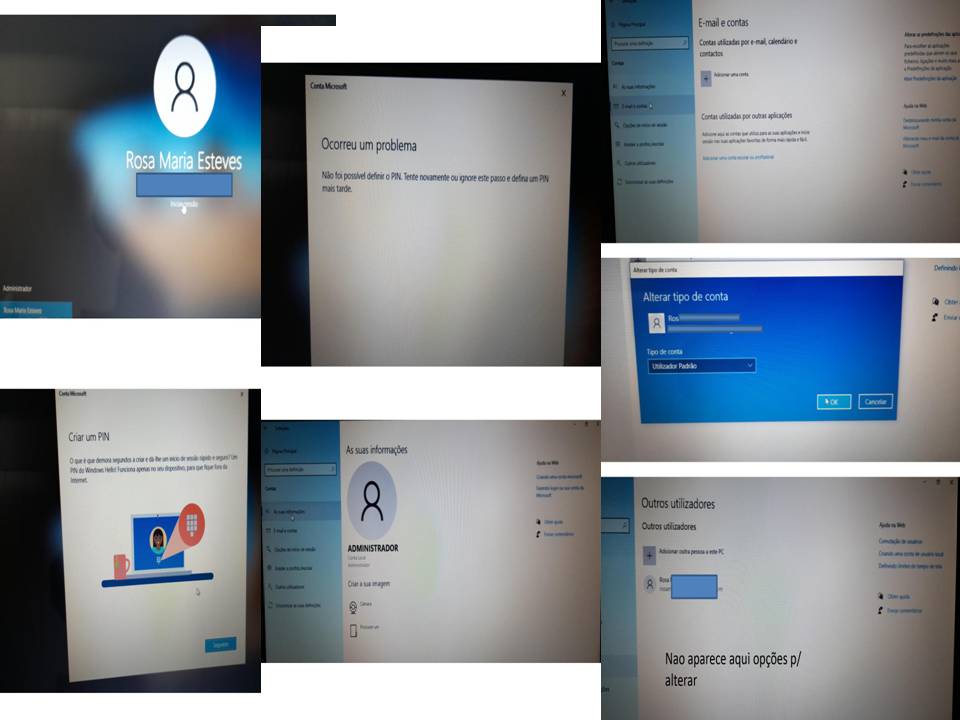

    Good evening,
    Can´t figure out what my son did to the computer that i can´t log with my Microsoft account but Only with Administrator.
    By log in with the Administrator acount i dont have my usual desktop with my files.
    In the beggining it ask for a Microsoft PIN but when i do the procedure to recover it it wont work. Always receiving a message that "its not possible for now... try again later.. "
    Now i get to the point where it says to creat a PIN. I do the procedure but then again it fails in the end with the same message
    In my Microsot account i had my phone number and my email so i believe that the acount is well configure.
    One time after several atempts and changes I also received a PIN in my email but than again when i insert it it wont work either.
    Cant figure out what is going on..
    Really i would love to delete this and get into the pc normally..
    If you see in these boards in the "ROSA" account i dont´even have any option to make any change on this matter..
    I aprecciate all help you could give me.
    Many thanks

  4. Windows Hello Issues. - Can´t get Pin Or Recover ou disable it. Tried everithing i know.
    Issues with Windows Hello PIN
    I understand that you are facing issues with Windows Hello PIN on your PC, and I certainly appreciate your efforts in trying to resolve the issue by following certain troubleshooting steps.
    You can follow the below steps to delete NGC folder and see if you are able to setup PIN.
    1. Press Windows + E to open
      File Explorer
    2. On the left hand pane click on This PC.
    3. Now navigate to the location C:\Windows\ServiceProfiles\LocalService\AppData\Local\Microsoft.
    4. Right click on the NGC folder and click on
      Delete.
    5. Click on Yes.
    In case you are receiving permission error then try running the command and see if you are able to delete it.
    1. Press Windows +
      S
      key together to open Search.
    2. Now type CMD and select Run as administrator.
    3. Accept the UAC prompts.
    4. Type in the following commands one by one and hit
      Enter
      icacls C:WindowsServiceProfilesLocalServiceAppDataLocalMicrosoftNgc /T /Q /C /RESET
    5. Close the CMD window
    6. Try to delete the NGC folder.
    Let us know how it goes.
