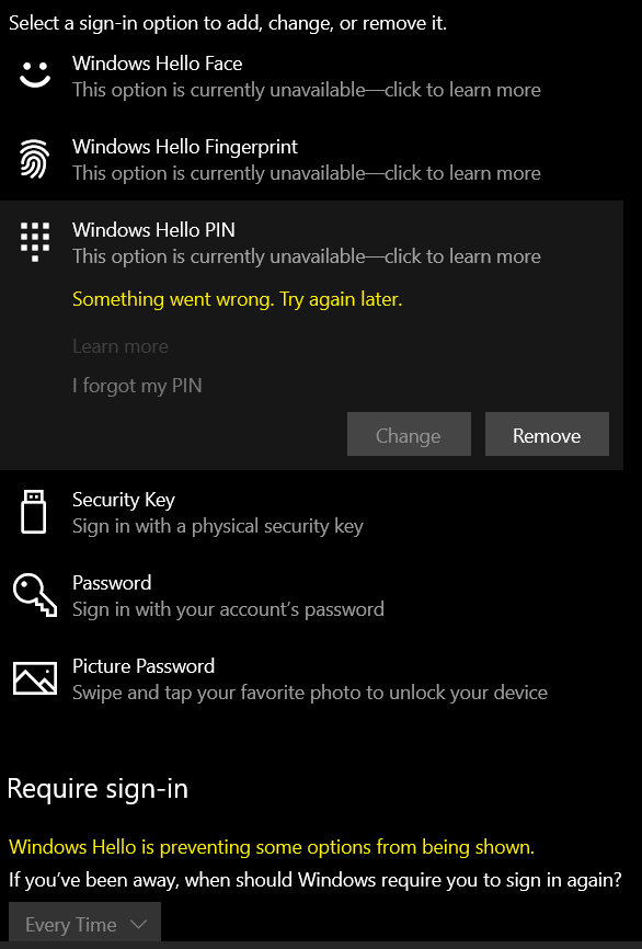

    Hi, This is jason.
    My problem is with the windows hello after the september 4 update. After restarting, the log in window told me to change my pin because it was invalid or something like that. It changed from a four number pin to six number pin. After changing the pin, I wanted to change the pin back, so i went to change it. The thing is that the option for changing both the pin and the fingerprint things displayed " something went wrong. try again later." I even contacted the windows support people to solve this issue, but after the in place upgrade that the tech support people told me to do. The problem was still not fixed.
    windows hello not allowing to change pin and add/remove fingerprint after update to 1903... b2651cd4-4ce2-495a-ab4c-8f8dc1732ec4?upload=true.png
