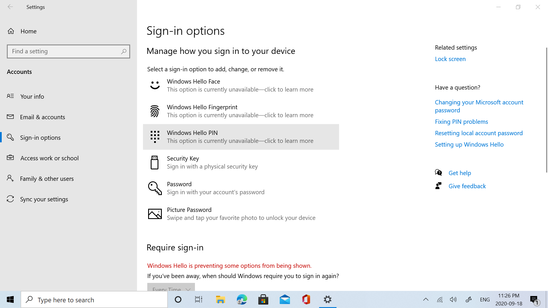

  4. BrentNevs Win User
    windows hello sign-in options are unavailable on my laptop
    All Windows Hello sign-in options are unavailable
    windows hello sign-in options are unavailable on my laptop fc2c6f9a-5949-4e47-98a0-d7b5d8e97f3b?upload=true.png
    I
    just purchased a ASUS Zenbook Flip S and Windows Hello worked when I set up my laptop, however right after setup, Face, Fingerprint and PIN sign-in options all say "This option is currently unavailable". I only set up PIN and Fingerprint during setup and I
    can still sign-in with them no problem, I just can't access them in settings.
