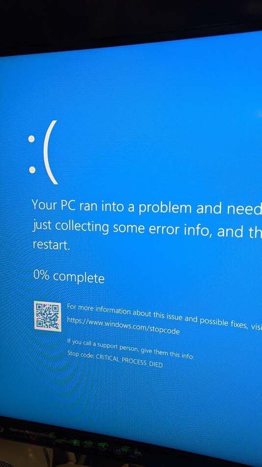

    Hello, community.
    I am trying to determine what is wrong with my computer. It has been crashing inconsistently, but with emphasis on my GPU and possibly the heat in my apartment.
    About a month ago, I started hearing odd noises from my XFX RX 580 8GB GPU, which I think means that one of the fans has been going out. Later, while playing a couple different games on my Windows PC, I have received a BSOD and the screen sticks at 0% reporting. While these may seem consistent, I cannot be certain that it is actually the GPU, because I have the side of the case off and the fans appear to be spinning when it is under load.
    I updated my AMD GPU drivers and then ran a 3DMark stress test on my GPU. The first time it ran fine, but when I ran the 3DMark test today, another BSOD. I have an image of the BSOD and will post it at the bottom.
    I am aware of Event Viewer, but if the reporting is stuck at 0%, would it even make a report? What would I be looking for?
    Here is my system:
    ASUS x79 Sabertooth motherboard.
    Intel i7 3930k 6 core CPU with water cooling AIO.
    32GB G-skill RAM at stock settings.
    XFX RX 580 8GB with stock cooler. The fans may be damaged from running a blower over it without suspending the fans.
    1TB M.2 SSD in PCI-e adapter with heatsink.
    Windows 10 x64, updated as of today.
    I am considering that I may need to replace the cooler on my GPU, but I would like assistance to determine that it is actually my GPU that is the problem and not something else I am overlooking.
    Thanks for reading.
    Windows is crashing again, need help to determine the cause. efafefba-7959-4799-9b3e-806b7ff5f738?upload=true.jpg
    Mindus Amitiel Debsin, Aug 2, 2020
