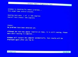

  2. Windows 10 Memory Diagnostics Tool
    As the first moderator has stated, the Windows Memory Diagnostic Tool would be taking its time to complete as it scans through your hardware. As it is advised to let it run overnight, it may still be stuck at certain points. We would suggest trying to remove
    some RAM sticks and let the tool run again. It could be possible that one of the memory sticks has an issue if the tool run without issues after removing one of them (if you're using more than one). if that would be the case, we would suggest replacing the
    memory in question to see if it helps.
    Let us know if there are other concerns.
    Jomel_Santos, Jan 31, 2021
  3. Windows memory diagnostic tool not Working in Windows 10
    I apologize for the inconvenience caused. We are glad to help you.
    We recommend that you let the Memory Diagnostics Tool run automatically. However, advanced users might want to adjust the tool's settings. Here's how:
    • When the Memory Diagnostics Tool starts, press F1.
    • You can adjust the following settings:
      • Test mix. Choose what type of test you want to run: Basic, Standard, or Extended. The choices are described in the tool.
      • Cache. Choose the cache setting you want for each test: Default, On, or Off.
      • Pass count. Type the number of times you want to repeat the test.
    • Press F10 to start the test.
    If the Windows Memory Diagnostics tool doesn't run automatically, you can run it manually.
    • Open Memory Diagnostics Tool by going to Control Panel. In the search box, type Memory, and then click Diagnose your computer's memory problems.
