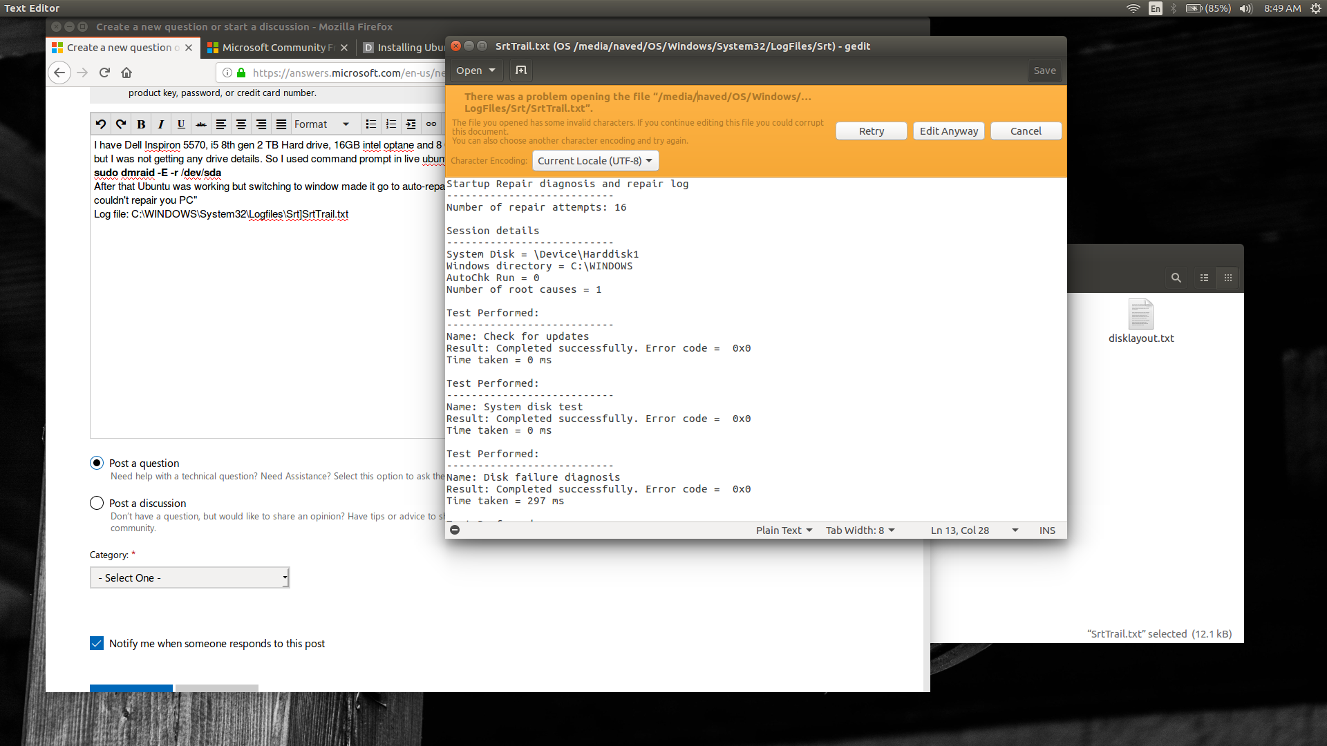

    I have Dell Inspiron 5570, i5 8th gen, 2 TB Hard drive, 16GB intel optane and 8 GB RAM. I tried dual boot my PC with ubuntu 16.04, but I was not getting any drive details. So I used terminal in live ubuntu environment with following command:
    sudo dmraid -E -r /dev/sda
    After that Ubuntu was working and I installed it in a separate partition. But switching to window made it go to auto-repair which didn't work. And it said "Automatic Repair couldn't repair you PC"
    Log file: C:\WINDOWS\System32\Logfiles\Srt]SrtTrail.txt Windows not working after dual boot 62a2a2a8-63c3-4628-8d38-c3db446175bb?upload=true.png
    I was unable to reset windows without removing my files (didn't even try reset with file removal).
