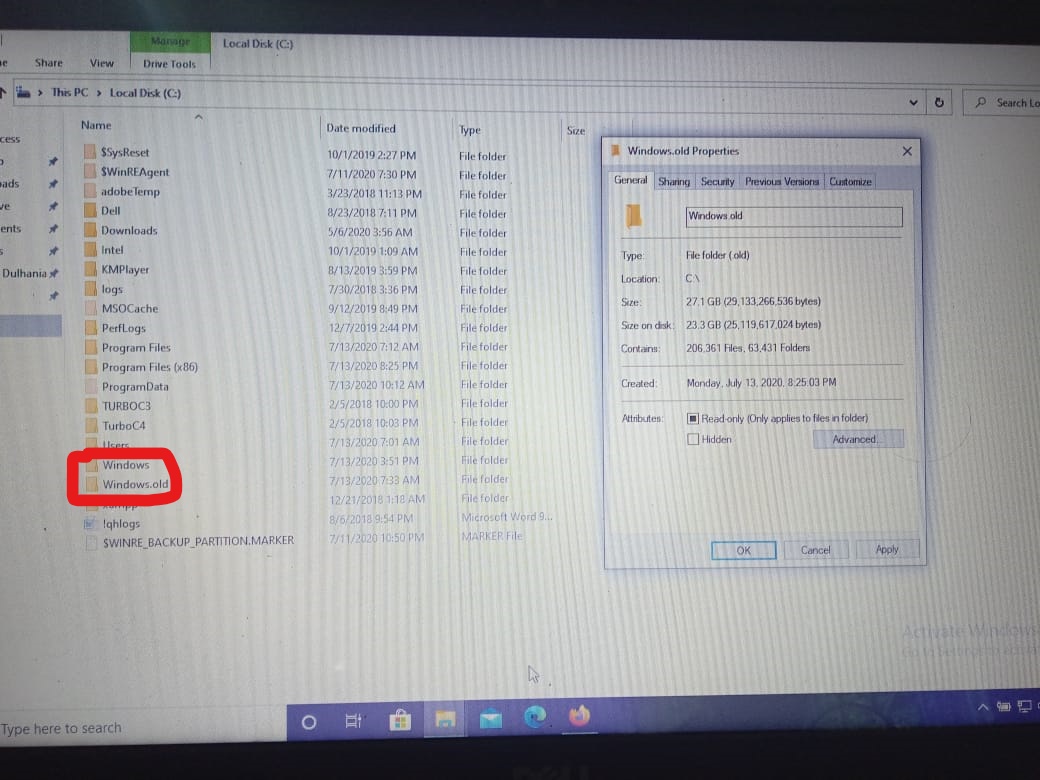

Discus and support Windows.old in Windows 10 Network and Sharing to solve the problem; After an update of windows my pc shows two new folder windows.old and windows. Can I delete the windows.old folder?[ATTACH]... Discussion in 'Windows 10 Network and Sharing' started by Kaushik_1801, Jul 13, 2020.
  1. Windows.old
    After an update of windows my pc shows two new folder windows.old and windows. Can I delete the windows.old folder? Windows.old b0798e10-4d99-4bb7-ad39-810209890603?upload=true.jpg

  4. Windows.old
    Windows.old
    Hi John,
    I understand your concern and will assist you to resolve these issues.
    Please follow these steps and check if that helps.
    Execute the following command in the Command Prompt in Elevated mode.
    • Press Windows key + X.
    • Click command prompt (Run as administrator).
    • In the Administrator: Command Prompt window, type the following commands. Press
      Enter key after each command:
    • RD /S /Q %SystemDrive%\windows.old
    • If the issue persists, I suggest you to give full permissions to the Windows. Old folder and try deleting it.
    Sudharshan M K, Jul 13, 2020
