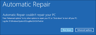

    For Christmas i got a dell optiplex 7010, which i believe is refurbished looking at the dust inside the case. on boxing day i turned on the pc and it came up with the error attached.the only way I can bypass this is to go into startup settings and click F7. (2nd pic) I was wondering if anyone will help as it is highly annoying. at the moment i believe it to be a bad install of windows by the refurbisher.
    Please help!! thanks

    Now I'm running into another issue.
    I cloned the HDD to Sony Evo 850 SSD using EaseUs todo (the program it came with- Sony Magician didn't work) with success but when I install the new drive it says it's not bootable.
    I've searched for this issue on other forums, but many answers pertain to Windows7, or have solutions involving DVD's (I have no blank ones, plenty of USBs however.) I'm hoping I can boot from USB, from what I've read it seems like I can get the proper drivers so it will know how to start up with the new SSD. If anyone knows how to do this, I would need step by step instructions.
    As a newbie to DIY computer repairs, I am feeling stumped at this point! I feel so close yet so far..
    Specs for my ultrabook: Acer m5 581t
    New SSD: 250gb sony evo 850
    Any hints or suggestions welcomed!
    Thanks!
