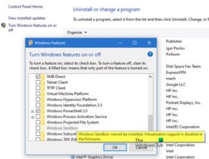

    Windows Sandbox cannot be installed, Virtualization support is disabled in the firmware

  4. Windows Sandbox cannot be installed, Virtualization support is disabled in the firmware
    Windows Sandbox not enble
    Windows Sandbox not appear in the start menu. I tried to enable it from "Turn Windows features on or off" but the Windows Sandbox appears in grey there and when I roll over it the message "Virtualization support is disabled in firmware" pop up. Please help
    on this issue.
    before installing Windows sandbox check to see if virtualization is enable by right clicking over taskbar and going to task manager then click the performance tab go down to Logical Processors under that is Virtualization which should say enabled,
    if not enabled virtualization in the bios refer to your computer guide for motherboard make and model,
    If Virtualization is enabled in the bios then you have issue with Windows 10 services under Administrative Tools.
    follow this below should get you going.
    For Windows 10 1903 sandbox wont start errors all you do is just restart the following service under Administrative tools
    Container Manager Services.
    then reopen sandbox should start up like normal.
