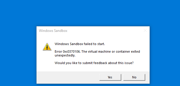

  1. Irvin22 Win User
    Windows Sandbox failed to start 0xc0370106
    Please Help
    Windows Sandbox failed to start 0xc0370106 9bb2c220-5451-49cf-8a55-7815e37f1281?upload=true.png
    Irvin22, Jun 30, 2019
