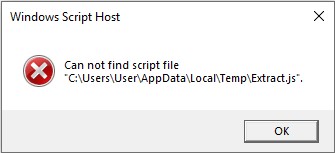

    Having this problem for few days. A few days ago I ran a file which was a malware Detected by windows defender. I removed the malware and after that this comes when I open my PC or working on PC. I updated my windows after this happens but didn't solve the problem. Please help me to solve this problem. Thanks in advance. Windows Script Host 0e096c62-72d6-4776-8fb1-a0b51b8e29f2?upload=true.jpg

    Hi Tiara,
    The message "Windows Script Host access is disabled on this machine. Contact your administrator for details" is usually occurring if a program that does not require the feature of Windows Script Host is running on a Windows PC. For us to provide an accurate
    solution, we would need you to answer the following questions:
    • Which build, version and edition of Windows is installed on your computer?
    • Does the message appear when you are launching a specific application?
    • What changes were made to the device before this issue happened?
    For initial troubleshooting, we suggest following the steps provided by
    Ramesh Srinivasan
    in this thread.
    We are looking forward to your response.

    Hi Boniface,
    Windows Script Host provides your PC the scripting abilities like
    batch files, but Windows Script Host offers more features. You can enable
    Windows Script Host to stop 'Windows Script Host is disabled on this machine, contact your administrator for details'
    message by following these steps:
    • Press Windows + R to open Run.
    • Type regedit and press Enter to open the
      Registry Editor.
    • Navigate to this key: HKEY_LOCAL_MACHINE\Software\Microsoft\Windows Script Host\Settings.
    • On the right panel, double-click Enabled and change the
      Value data to 1.
    • Save the changes and exit the Registry Editor.
      Note: Do not modify other keys on the Registry without having enough knowledge about that registry key as it may cause some failures on your PC
    Let us know how things go.
