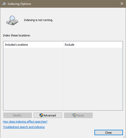

    I just got an alert on my computer that search indexing was turned off and to turn it back on, I did that and went through the process of opening Indexing options, advanced search, press rebuild etc. However it is simply isn't working. The photo above is a screen cap of what it is doing. It simply says ''indexing is not running'' and that's the problem, i went to index it and it simply isn't indexing anything. Anyone have any suggestions of why it is doing this? thanks a lot

    System conflict is one of the possible reasons why the index built will not function properly. We suggest running the Search and Indexing troubleshooter by following these steps to resolve your issue:
    • Open Control Panel.
    • In the search box, type troubleshooting.
    • Click on Troubleshooting.
    • Click on View all.
    • Select Search and Indexing and select the proper scenario that you are experiencing on indexing and click
      Next for the troubleshooting to begin.
    Update us with the outcome so we can provide you further assistance.

    This issue may occur due to corrupt Windows search files or settings. I suggest you to follow the below method and check if it helps.
    Method 1: I would suggest you to run search and indexing troubleshooter
    and check. Please follow these steps:
    • Type troubleshooting in the search box on taskbar.
    • Click troubleshooting in the search results.
    • Click "View all" and then click "Search and Indexing".
    • Click "Next" and follow on-screen instructions.
    Method 2: Check if Indexing and Windows Search services are enabled. If not, enable them, if they are already enabled, then disable Windows Search Service and then enable again and restart.
    • Press Windows key + R.
    • Type services in the run box, go to the Windows search services and restart them.
    Hope it helps.

    I understand your concern and will assist you to resolve this issue.
    I suggest you to follow the steps below and check if it helps
    • Type Services.msc In the search box.
    • Select Windows Search
    • Restart the services and set the service as Automatic
    If the issue persist try performing Rebuilding Index again.
    To rebuild the index follow the steps below:
    • Open the Control Panel from the Start menu.
    • Open Indexing Options in the Control Panel.
    • Select the Advanced button in the Indexing Options window.
    • Select Rebuild in the Troubleshooting section of the Advanced Options window.
    • Select OK when it asks if you’re sure you want to re-build the search index.
    Hope this helps. If the issue remains unresolved, please get back to us and we would be happy to help
