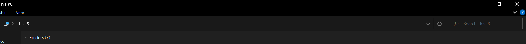

    Windows search option is unresponsive.
    When I click on the search bar option in my desktop it's unresponsive. My Cortana is working fine. Even when am trying to click on the task manager options I can't find any SearchUI.exe and due to that I can't even end the task and do the needful. When I am selecting the 'This PC' icon and after entering into it when I want to search for any files in 'This PC' it's unresponsive. PLEASE HELP!!!

  2. Arun B J Win User
    Search option is not working properly in Windows 10
    • Are you referring to Magnifier in windows?
    • Are you facing issues with Magnifier or Search bar?
    • Since when are you facing this issue?
    • Did you make any changes prior to this issue?
    Step 1: Restart the Service and check if it helps.
    • Press Windows key + R.
    • Type Services.msc In the search box.
    • Select Windows Search.
    • Restart the services and set the service as Automatic.
    Step 2: Run the
    Search and Indexing troubleshooter.
    Follow the steps below and check if it helps.
    • Press Windows key +X, select Control panel.
    • Change the view by option on the top right to
      Large icons.
    • Click on troubleshooting and click on the
      view all option on the left panel.
    • Run the Search and Indexing
      troubleshooter.
    Reply with necessary information so that we can assist you better.
