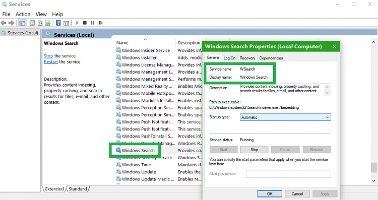

    wsearch won't start, error 5 access denied
    I guess when the service itself has an issue, it renames itself to the "Service name" instead of "Display name".

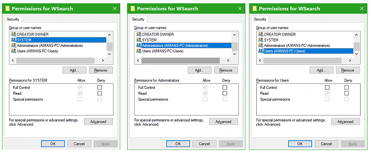

    - - - Updated - - - Try these suggestions: c# - windows could not start service on local computer error 5 access is denied - Stack Overflow - - - Updated - - - Another idea, similar to: DHCP Client service Error 5: Access is denied 1) Open Registry Editor and go to: 2) Computer\HKEY_LOCAL_MACHINE\SYSTEM\CurrentControlSet\Services\WSearch 3) Right click WSearch, and press Permissions... Do all these look similar on your computer? If not, then make them similar and restart your computer:
    Windows Search service fails to start: Error 5: Access is Denied 369845d1656364082t-wsearch-wont-start-error-5-access-denied-image.png
    After the computer restarts, see if Windows Search works - - - Updated - - - Here are search results for having an exactly the same Permissions error for a Service: "windows could not start the "+"error 5 access is denied" - Search This could widen the horizon of different possibilities that you can try to fix the error if none of the above worked.
