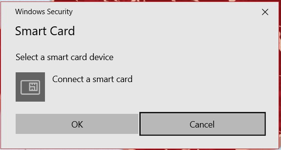

    When starting my computer I get the popup attached below, it comes up and has to be dismissed a total of four times. This happens on two different Windows 10 devices I use. I use a smart card to access enterprise webmail on occasion and that works without issue. I do not use the smart card to log into my personal devices. The popups did not start on my new device until the first time I used the USB smart card reader.
    I have not found anything that I am unable to do without hooking up the card and have no issues accessing the website that require the smart card so this is an annoyance not a capability breaking issue. I have seen similar questions asked multiple times without a clear resolution. I'm guessing that there is a setting somewhere that gets turned on when a smart card is introduced and I would like to disable it upon login.
    Windows Security Smart Card popup 75d4cbac-1132-4116-a733-f658ac196b33?upload=true.jpg

  3. Windows 10 Smart Card Error
    We understand the difficulties you are facing while booting the PC to Windows 10 as you are getting the option to use your smart card login.
    This could be due to accidentally configure the Windows system to allow only smart card login.
    Cards are a portable, secure and a tamper-proof way to provide security solutions for tasks such as client authentication, logging on to domains, code signing, and securing e-mail. In order to get clarity and to assist you accordingly,
    please reply with the answers to the questions below
    • What is the Windows 10 version and Build installed? (Type
      winver in Windows search/Run command)
    • Does the PC connected to any domain network?
    • Are you aware of any recent changes on the PC, prior to this issue?
    However, you can try these methods and check if you are able to disable the smart card login.
    Method 1: Disable Force Smart Card Login
    If a problem prevents you from logging in to Windows with a smart card, start your computer in safe mode and disable this security feature. Smart Card Login option will not be available in Safe Mode. Whether
    you log in with a physical or virtual smart card, Windows stores your settings in the Windows NT Registry. If you’re able to log in to Windows, you can disable smart card login for future sessions by editing your local group policies. Disabling the Smart Card
    Plug and Play service removes the option to insert a smart card when logging in.
    1. Login to Windows in Safe mode, please follow this
      safe mode article.
    2. Press Windows + R key to launch
      Run command.
    3. Type regedit in the Run dialog box and click OK.
    4. Navigate to the following key:
      HKEY_LOCAL_MACHINE\Software\Microsoft\Windows\CurrentVersion\PoliciesSystem
    5. In the right pane of this location, you’ll find a DWORD named scforceoption.
    6. In the Value Data field, change the current value of “1” to “0” and click “OK.”
    7. Close Registry Editor and restart your computer in normal mode. The login screen prompts you to enter your username and password rather than insert a smart card.
    Method 2:
    Disable Smart Card Plug and Play Service.
    1. Press Windows + R key to launch Run command.
    2. Type gpedit.msc in the Run dialog box and click OK.
    3. Navigate to “Computer Configuration>Policies>Windows Settings>Local Policies>Security Options>Interactive logon: Require smart cards”
    4. Right-click “Interactive logon: Require smart cards” and select “Edit.” In the Properties dialog, select “Disabled” to turn off this service
    5. Now navigate to “Computer Configuration>Administrative Templates>Windows Components>Smart Card>Turn On Smart Card Plug and Play Service”
    6. Right-click “Turn On Smart Card Plug and Play Service” and select “Edit.” In the Properties dialog, select “Disabled” to turn off this service and remove the smart card option from the login screen. Click
      “Apply” and “OK” to save your changes.
