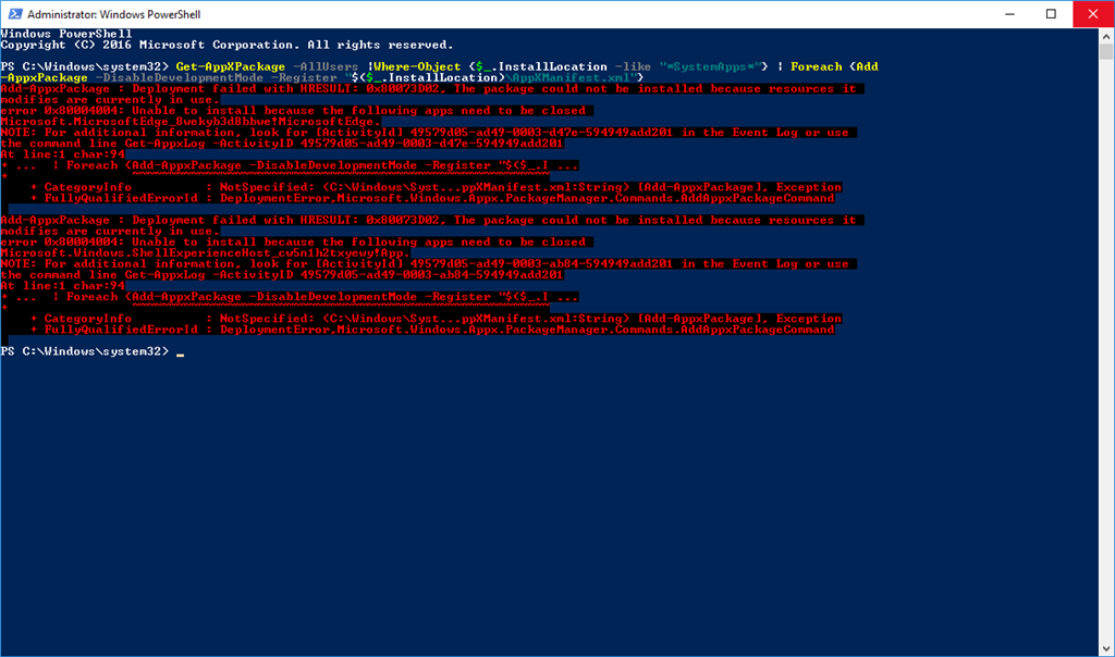

  1. Windows Spotlight Stuck on a Pic and Powershell deployment shows below message
    am getting the attached message when trying to resolve spotlight stuck issue using Powershell Windows Spotlight Stuck on a Pic and Powershell deployment shows below message 95980f1b-0630-4d0d-8b8e-f79953c72795?upload=true.png

    Thank you for providing us more information. In this case, we suggest that you perform the following steps to reset Windows Spotlight:
    • Delete the folder Microsoft.Windows.ContentDeliveryManager_cw5n1h2txyewy.
    • Open the Start menu, and search for PowerShell.
    • Copy and paste the following command into the PowerShell prompt, then press
      Enter
    Get-AppXPackage -AllUsers -Name Microsoft.Windows.ContentDeliveryManager | Foreach {Add-AppxPackage -DisableDevelopmentMode -Register "$($_.InstallLocation)\AppXManifest.xml" -Verbose}
    Regards.
    Aileen Alf, Dec 18, 2018
  3. Spotlight only shows depressing pics
    To further troubleshoot the issue with Spotlight, follow these steps:
    Method 1: Run the built-in Troubleshooter.
    • On the Search bar, type Find and fix problems.
    • Under System and Security, click Maintenance task.
    • Click Next and follow on-screen guide.
    Method 2: Clear the Assets Folder.
    • Turn off Windows Spotlight.
    • On the File Explorer, go to: C:\Users\Username\AppData\Local\Packages\Microsoft.Windows.ContentDeliveryManager_cw5n1h2txyewy\LocalState\Assets
      (replace the Username with your own username)
    • Delete the content of the folder.
    • Activate Spotlight and lock the screen.
    • Check if issue still persist.
    Let us know how it went
    Jennifer Cha, Dec 18, 2018
  4. Windows Spotlight Stuck on a Pic and Powershell deployment shows below message
    To get the spotlight to work correctly on your PC, we recommend that you follow the troubleshooting steps provided by Navneet Anand through this
    link.
    Let us know how it went.
