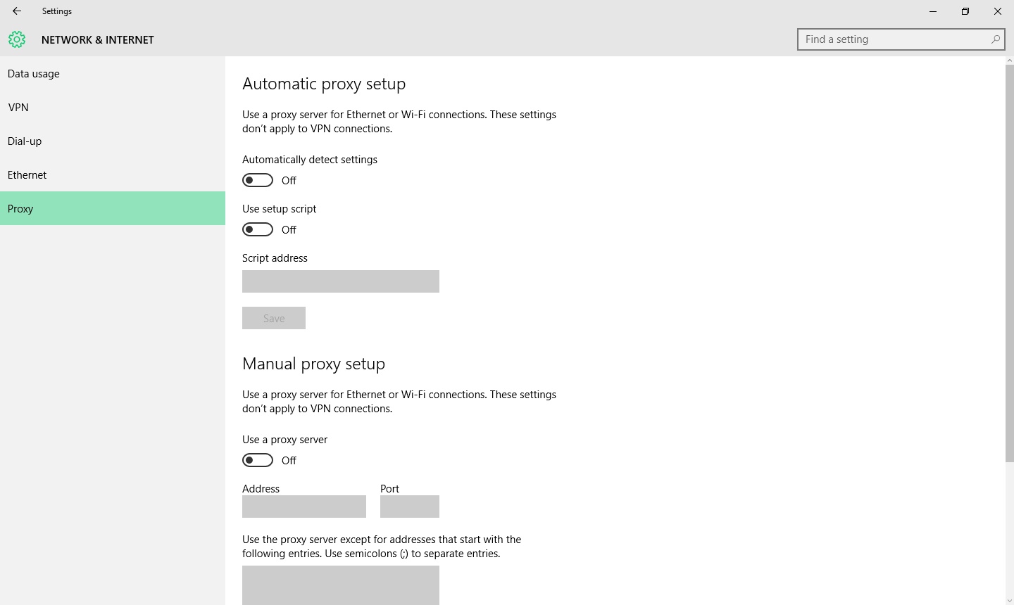

  2. Windows 10 store won't connect to the internet
    Sometimes using proxy to connect to the internet may cause issues while connecting to the network.
    Follow the steps below to disable proxy:
    1. Open the New Modern Settings
    2. Select Network & Internet
    3. Go to Proxy
    4. Disable Use Proxy Server
    Now Open Windows Store it should work if it doesn't try to also Disable Automatically Detect Settings & Use Script Setup.
    Alternately Try Enabling them, & some enable disabled combination with these 3 options.
    Even after that if it doesn't opens Try the Following:
    Navigate to
    %LOCALAPPDATA%\Packages\Microsoft.WindowsStore_8wekyb3d8bbwe\LocalCache
    and delete all the files and folders. Open the store. Now it should open.
    Sudipta Biswas, Jan 16, 2019
