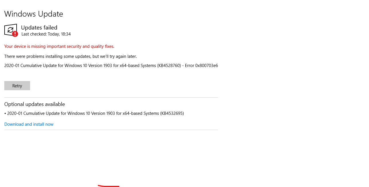

  4. Windows Update Error 0x800703e6
    Hey Microsoft Community
    I am trying to update my windows 10 1903 to 1909 but i am facing a error
    This error is 0x800703e6
    I have spent my huge time in finding the solution to this problem but still not solved
    My PC Info is as follows :
    Windows Version : 1903
    Edition : Windows 10 Pro
    OS Build : 18362.388
    Please if someone knows how to fix it please answer
    Here is the screenshot of it
    Windows Update Error 0x800703e6 6b61b4e5-f51b-41fd-8df5-2aa9d0893abb?upload=true.png
    Ankur Deewan, Aug 12, 2021
