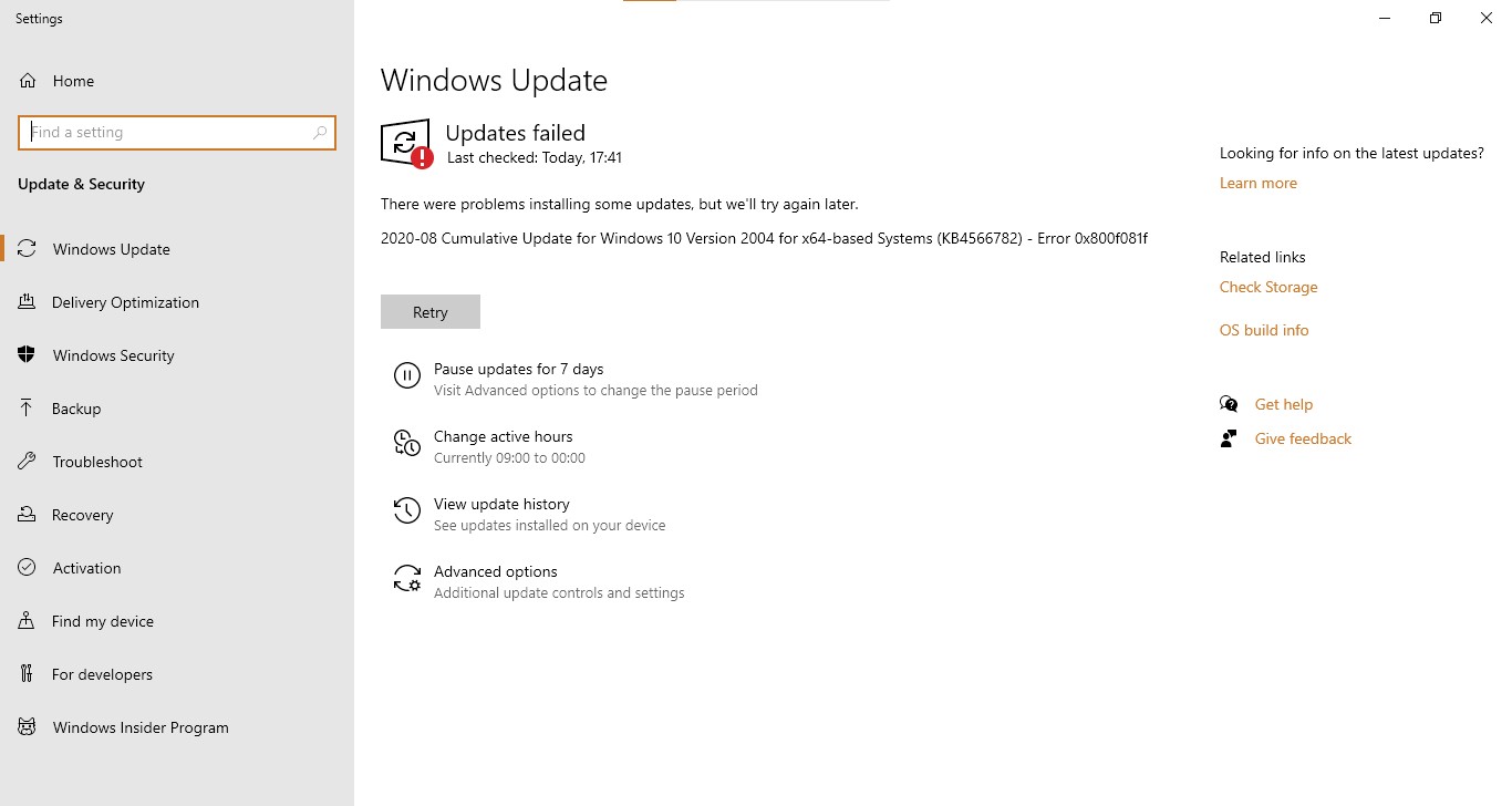

  1. Windows Update Error installing KB4566782 - Error 0x800f081f
    Windows Update keeps failing with the error code Error 0x800f081f.
    Even Manually updating using the *.msu package fails.
    Windows Update Error installing KB4566782 - Error 0x800f081f 874e8729-f20b-4ad1-9e97-b76dfacc326b?upload=true.jpg
    Manoj Kumar, Aug 30, 2020
