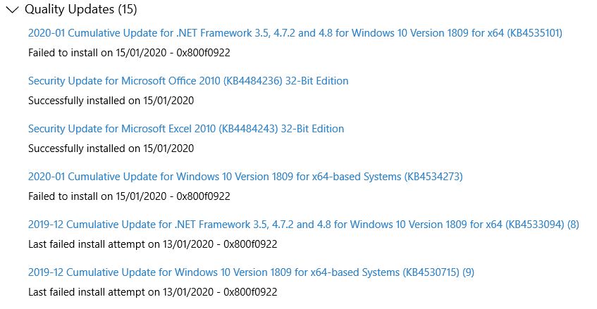

    Getting Windows update Failed to install 0x800f0922 a number of times. Windows update gets to about 92% then says failed update. This is the update history:

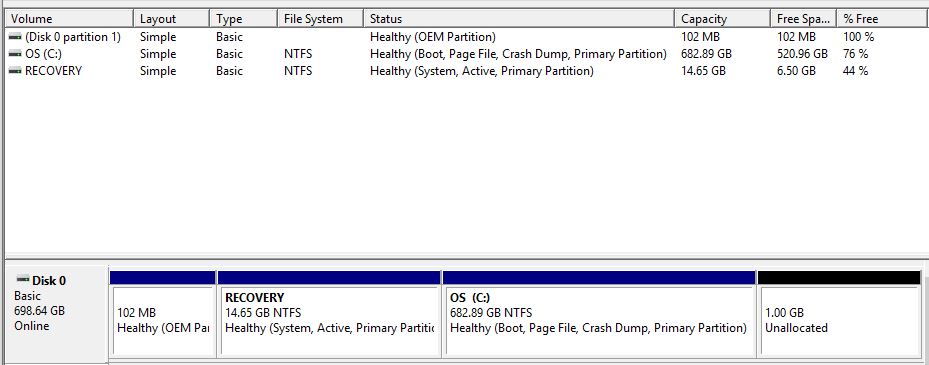

    Have checked there is enough space on the SRP but looking in disk management there doesn't seem to be one. I created 1gb unallocated space to add to the SRP then realised there wasn't one:
    Windows update Failed to install 0x800f0922. No SRP when checked in Disk Management 66a4f18a-da89-4733-97e3-a8a049f4ef27?upload=true.jpg
    Is this reason my windows update is failing? How do I resolve this?

  2. jds21 Win User
    I just did step one and they have just all installed.... thank you so much.... it was quite frustrating having that update window pop up every 5 minutes and failing to instal every time
    Thanks mate
    jds21, Jan 17, 2020
