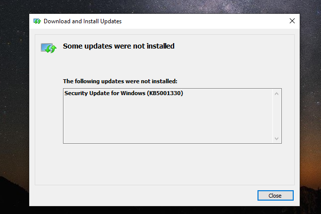

    Hey community i am getting a problem of windows update.i was planning to install KB5000802 update on 13 april 2021 but it was replaced with KB5001330 so i downloaded it and it stucked at 100%. Then i pause the update and resume it again. when it was downloaded it again stuck at 100%. i thought that i didnt install KB5000802 update so thats why it was stucking then i installed the Kb5000802 update frome microsoft update cateloge and successfully installed it then i again try to download KB5001330 update but again stuck at 100% then i decided to install it from update catologe and when the installation begins after 5 minutes it shows this and i got this error code on windows update history 0x80070026
    Windows update KB5001330 not installing fe91cf4a-c45b-4ee9-b9ac-9f056b45a3a9?upload=true.png
    Please help me to keep my windows up to date
    My windows version is 20H2 and 64 bit system the update name is= Culcumative update for windows 10 version 20H2 for x64 based system. And i also got Security intelligence update for windows defender antivirus and it successfully installs daily.
    Pls helllpppp meeee
