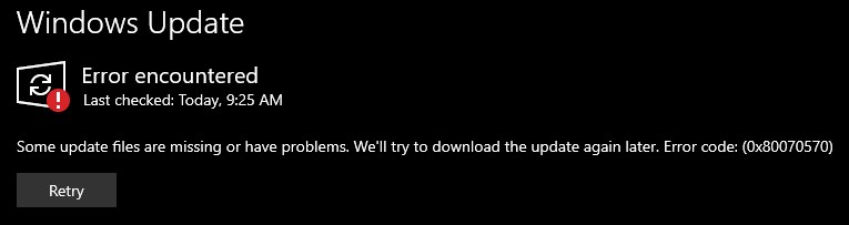

    For the last few months, Windows update has failed to installed any patches. I keep getting the following error: 0x80070570
    Windows Updates Failing a5f5550d-1965-47e6-bd2a-99d778598a3c?upload=true.jpg
    Today, I noticed the following in the System Event log after trying to install the updates:
    Unable to start a DCOM Server: {0823B6F8-F499-4D5E-B885-EA9CB4F43B24}. The error:
    "2147943792"
    Happened while starting this command:
    C:\WINDOWS\winsxs\amd64_microsoft-windows-servicingstack_31bf3856ad364e35_10.0.19041.680_none_e72768c3263f99bc\TiWorker.exe -Embedding
    The Windows Update troubleshooter doesn't find anything wrong.
    I've tried everything from this thread: Windows 10 Update error code 0x80070570
    Nothing seems to fix the issue.
    J_Jensen_81, Mar 3, 2021
