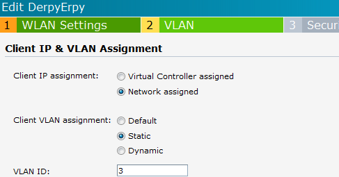

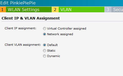

    does yours do it like this:
    For example:
    Cisco Meraki Z1: two VLANs: main=vlan10, guest=vlan 3 all ports trunk and allow all vlans (default=10)
    Aruba RAP109s: main ssid:networks assigned:untagged guest ssid:network assigned:tag=3
    Windows VLAN chaos: How do I stop Windows combining untagged and phone vlans? instant-arubanetworks-com_2014-09-20_17-51-30-png.png
    Windows VLAN chaos: How do I stop Windows combining untagged and phone vlans? instant-arubanetworks-com_2014-09-20_17-51-54-png.png
    and it works... but when I tag the first one in the AP config clients don't obtain IPs... aruba support told me that that is how it needs to be done.
