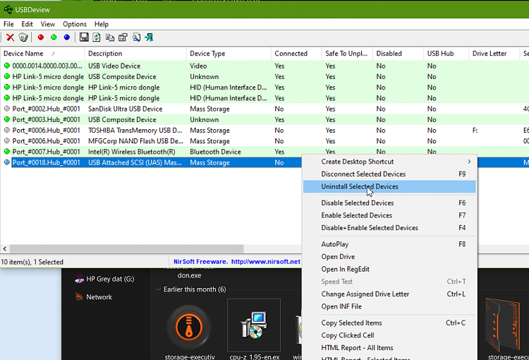

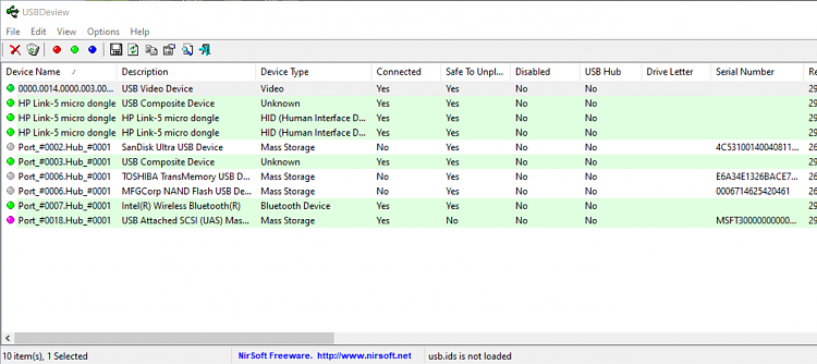

    Just for future reference Nirsoft's USBDeview is a handy utility. View any installed/connected USB device on your system (nirsoft.net), 64-bit download at bottom of page.
    I've uninstalled the driver for an unconnected USB external drive and then reconnected it forcing Windows to identify it again. Might have helped.
