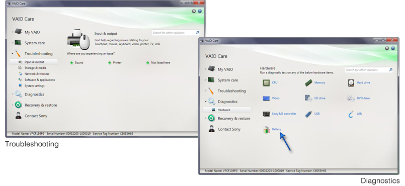

  3. DaveM121 Win User
    How to fix sony vaio laptop battery.
    This can be caused by a software (driver) issue or a hardware issue . . .
    • Open Device Manager (accessible by right clicking your Start Button)
    • Expand the batteries section and look for 'Microsoft ACPI-Compliant Control Method Battery'
    • Right click this device and select 'Uninstall'
    • Shut your laptop down
    • If possible remove the battery and the power supply
    • Press and hold the power button for 30 seconds
    • Put the battery back into your laptop and also the power supply
    • Start your laptop and check to see if it is detected and charging
    Otherwise, your battery may be at the end of its life, you can check this in Sony Diagnostics:
    Open the VAIO Care™ utility this will launch the Troubleshooting utility
    Go to System Care - Troubleshooting - Diagnostics
    Windows10/Sony vaio laptop battery not charging cf678220-1f20-43ac-9b09-02d593284046.jpg
