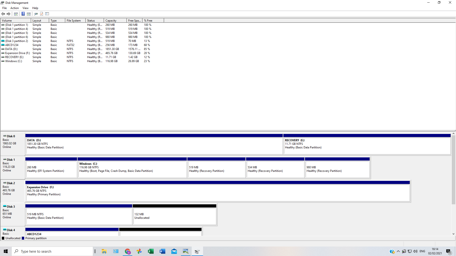

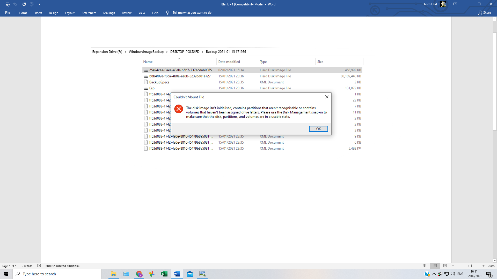

    Sirs,
    Attached is the response to me trying to look at 'WindowsImageBackup' files on my external hard drive. Attached also 'Disc Management' screenshot. Any guidance would be appreciated please. WindowsImageBackup 4d7ed613-e28d-491b-b353-c76b630caeae?upload=true.png

    I'm getting a head start in case you get on early.
    Can you post camera pics to your thread from your phone?
    There will be steps later that require attention to detail and I'd feel better if I could see what's on your screen. I had to try the steps more than once when I tested the process and I'd like to avoid that on your machine.
    Here's what I'd like to do for the Macrium Rescue steps later on in the process
    I'll post the the step, you'll post an picture of the Macrium screen,
    I'll echo same screen back if I see something that needs changing or I'll just say Go Ahead
    When I confirm that the Macrium screen, you'll make any changes I've highlighted and THEN execute the step
    Here's where you begin today's session, we'll get as far as we get and then pick up when you get back home.
    Step 1: Safeguard the System Image by moving it to a new folder
    1. Connect the Seagate exp drive
    2. File Explorer: Navigate to the Seagate drive
    3. Create a new Folder named 1_sysImage
    4. Move WindowsImageBackup to 1_sysImage
    Step 2: List the VHDs in the System Image
    1. File Explorer: Navigate to 1_sysImage\WindowsImageBackup\machineName\Backup date-time
    2. Press the Type column to sort by Type
    3. Post a screen shot
    Slartybart, Feb 2, 2021
