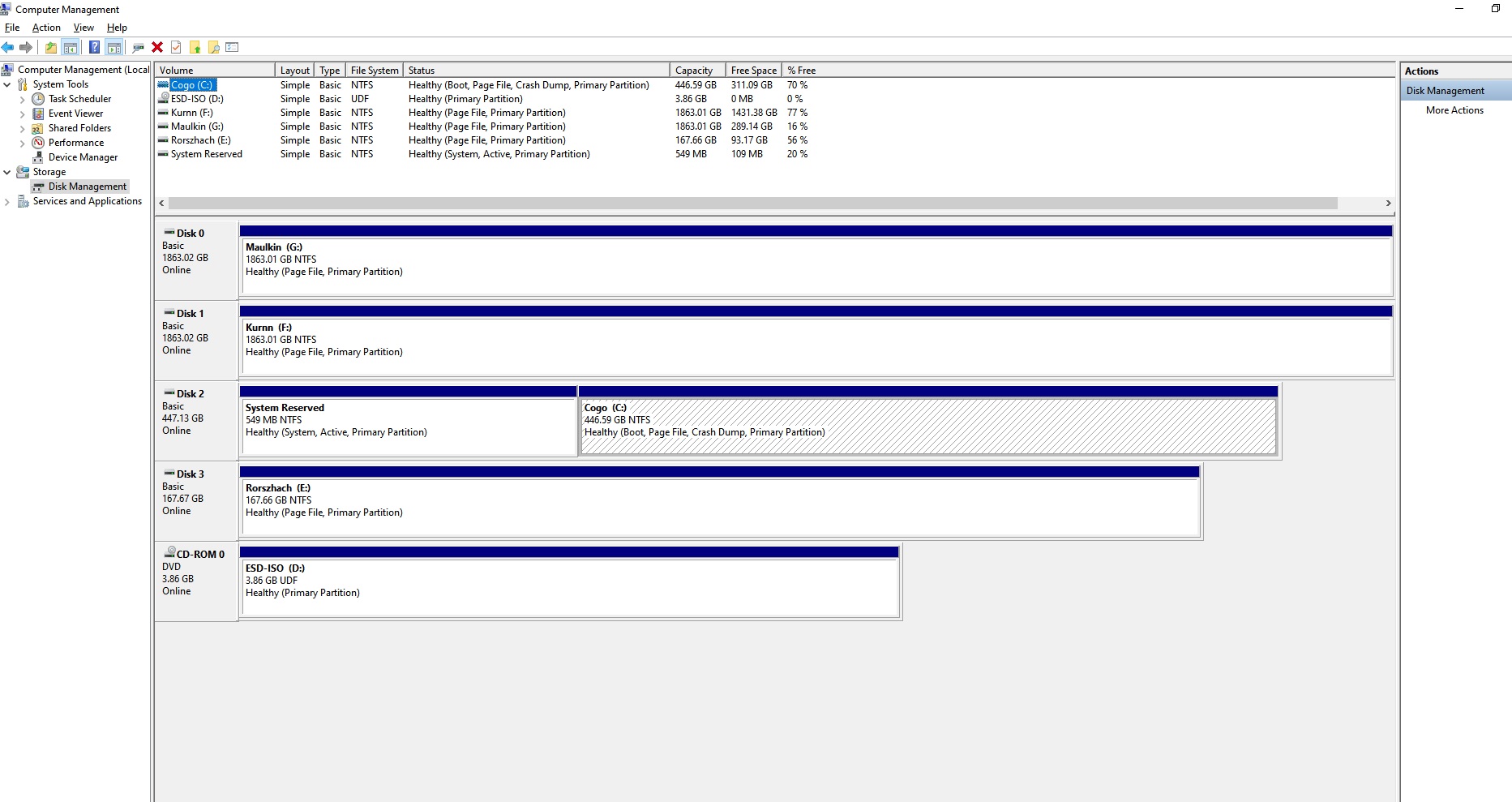

  2. Winre on my Win 10 isnt working after a system restore. Possible to fix WinRe, or do I need to re-install Win 10?
    Hey!
    Thanks for replying so quickly.
    Here is my Disk manager:
    Winre on my Win 10 isnt working after a system restore. Possible to fix WinRe, or do I need... bc5a0930-4e14-4806-9531-be01690be141?upload=true.jpg
    Does a USB Win 10 Installation Media work the same way as WinRE?
    If so, Ill hold off with the clean install.
    But I THINK my system restore isnt 100% if WinRE is missing. However, it did work.
    Any other SS och logs you want to look at?
    Jonas The Swedish Goth, Oct 1, 2019

  4. Winre on my Win 10 isnt working after a system restore. Possible to fix WinRe, or do I need...
    Jonas -
    The steps for drivers are important enough that they are printed in red, so please do look over and compare the install in the link because it's been used by millions and no one ever returned with another problem I have seen as long as they followed the
    steps.
    See here how to remove duplicate files easiest:
    How to Find (and Remove) Duplicate Files in Windows 10
    Did you see the tutorial I also gave for how to restore the Recovery partition?
    Restoring Windows Recovery Environment (WinRE) in Windows 10 | Windows OS Hub
    Greg Carmack - Windows MVP, Oct 1, 2019
