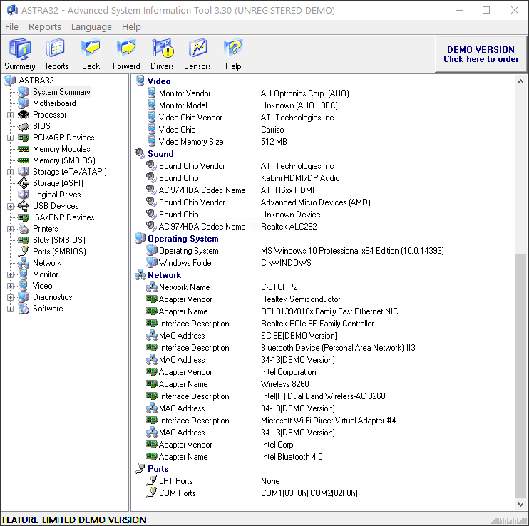

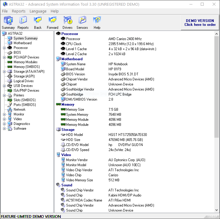

  3. Cee Vee Win User
    This device cannot start. (Code 10). Intel dual band wireless-ac 8260
    For my system information, please see attached snippets/pngs.
    1. Dual band wireless-ac 8260 driver v.19.1.0 with Bluetooth driver v.19.0.1621 is not working, giving: This device cannot start. (Code 10).
    2. Also tried: Dual band wireless-ac 8260 driver v.19.0.1 with Bluetooth driver v.18.16.1 is not working, giving the same as in item 1: This device cannot start. (Code 10).
    3. Also tried inter-mixing the above drives; still is not working, giving: This device cannot start. (Code 10).
    4. Deleted/uninstalled the said drivers and let Windows 10 install the drivers - for ac 8260 driver v.18.40.0.12; for Bluetooth driver v.19.0.1621, everything is working fine. There might be a conflicting problem/s with the latest ac 8260 drivers.
    5. Last weird thing regarding item 4; If I "RESTART" my laptop; I also get not working: This device cannot start. (Code 10).
    6. But if I "SHUTDOWN AND START" then wait for about 20 seconds; everything is fine, the wi-fi/bluetooth works.
    Your respond/explanation/fix is highly appreciated.
