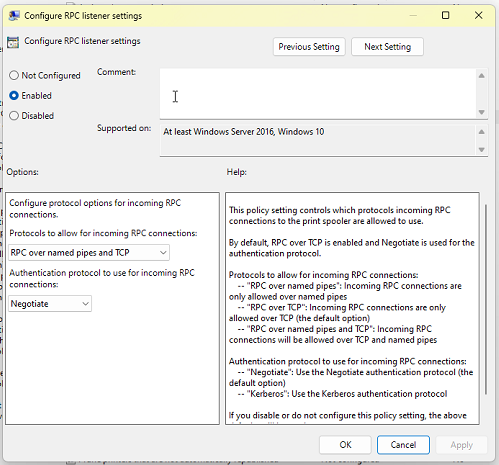

    this method only applies if windows 11 22H2 as a client, if as a printer sharing server then there are additional settings that must be done
    if your windows 11 22H2 is a printer sharing server, then you should try to enable these 2 ways
    Configure RPC listener settings => change protocol : RPC over named pipes and TCP
    with the printer sharing server is windows 11 home 22h2 .the client is windows 7 and... ext?url=https%3a%2f%2flh6.googleusercontent.png

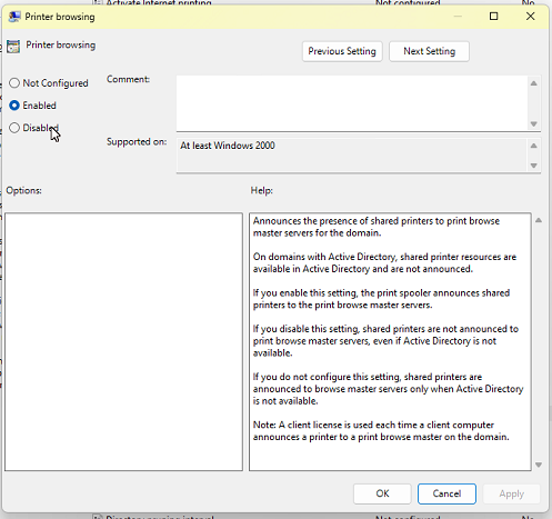

    Printer Browsing
    with the printer sharing server is windows 11 home 22h2 .the client is windows 7 and... ext?url=https%3a%2f%2flh5.googleusercontent.png
    good luck...
