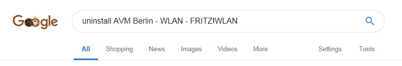

    When I performed a Google search like this:
    wlan Konflikt Realtek usb 2.0 wlan adapter mit Fritz!wlan Stick AC430 394f2e36-4fa2-4ea4-824d-82801e78d466?upload=true.jpg
    ...turned up these instructions:

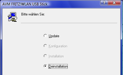

    1 Using the latest driver to uninstall
    1. Download the latest driver for your FRITZ!WLAN Stick from our FTP server
      ftp://ftp.avm.de/archive/cardware/
    2. Run the downloaded file "avm_fritz!wlan_usb_stick....exe" (double-click the file in the Windows Explorer, for example).
    3. Click "Yes" and "Next" until the window "Welcome to the Windows setup for the AVM FRITZ!WLAN USB Stick" appears.
    4. Click "Continue" and select "Removal" in the next window. If you cannot select "Removal", then the driver has not been installed yet. In this case, click "Cancel".
      wlan Konflikt Realtek usb 2.0 wlan adapter mit Fritz!wlan Stick AC430 73.png
      Fig.: Using the latest driver to uninstall the FRITZ!WLAN Stick
    5. Confirm with "Next".

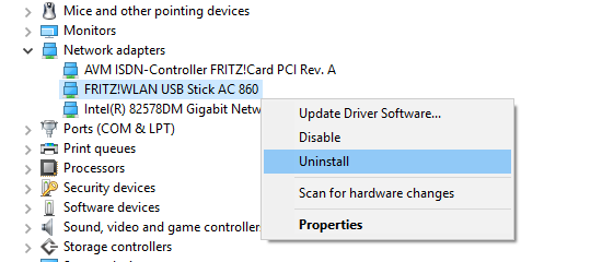

    2 Using the Windows Device Manager to uninstall
    1. Press the keyboard shortcut Windows key
      wlan Konflikt Realtek usb 2.0 wlan adapter mit Fritz!wlan Stick AC430 272.png
      + Pause key.
      • The window with basic information about your computer opens.
    2. Click "Device Manager".
    3. Open the device class "Network adapters".
    4. Right-click "AVM FRITZ!WLAN USB Stick" and select "Uninstall".
      wlan Konflikt Realtek usb 2.0 wlan adapter mit Fritz!wlan Stick AC430 219.png
      Fig.: Using the Device Manager to uninstall the FRITZ!WLAN Stick
    5. Follow the instructions.
