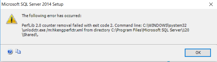

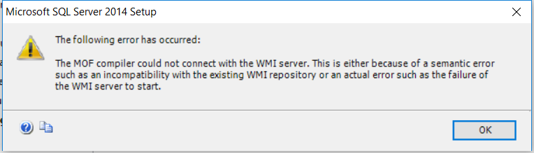

  3. lucky_37 Win User
    How to resolve the 'MOF compiler could not connect with the WMI server ' when installing SQL SERVER 2014 ?
    Hi ,
    This is Sagar
    2 weeks back i used both sql server 2014 & visual studio 2015 in my laptop ,due to some problems i was uninstalled visual studio 2015 .After uninstalling visual studio sql server management studio(SSMS)tool was not opened , so i was uninstalled sql server
    also .Now everytime When i want install sql server 2014 , it showed an error message box
    WMI -- Filtering on only Workstations/Servers that are Build 17763 and greater ffdb68d4-61c1-4028-b5c4-6ce43dd46ce5?upload=true.png
    i was tried many times and many ways eventhough it showed same error message , it also showed some additional error messages
    WMI -- Filtering on only Workstations/Servers that are Build 17763 and greater 2cca7554-bd8b-4844-970d-248107056c9d?upload=true.png
    At the end of Completion of sql server setup , it showed following summery

    Will anyone give solution for this problem .
