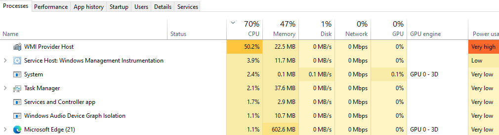

    WMI Provider Host error - can't find problem service
    My CPU is running at 70% to 100% because of WMI Provider host.
    Windows 10. Ver. 1909. 64 bit. No issues after scanning. Dell updates and diagnostics all OK.
    WMI Provider Host error - can't find problem service e086bb08-3c6c-46c4-9942-93c5b5d34fb3?upload=true.png

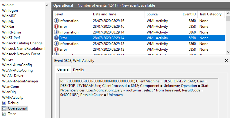

    When I open the event viewer it can be seen the Process ID causing the issue is 8612.
    WMI Provider Host error - can't find problem service 25e0cfb2-ee2b-490d-a65d-5dcb27480d7a?upload=true.png

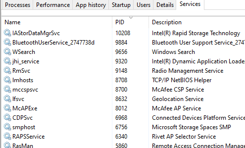

    When I open the task manager, I cannot see the offending item in the list of Services. I’m assuming this is what needs to be dome.
    What do I do to get rid of the item causing the error?
    Thanks in advance.

  2. KBranigan Win User
    WMI Provider Host High CPU and 2 of them
    WMI Provider Host High CPU and 2 of them listed in task manager. I looked online and can't find simple steps as I don't know what some actions are when people speak
    KBranigan, Jul 28, 2020
  3. WMI Provider Host - Windows 10
    We understand your concern as you the WMI provider host use high CPU of the PC. Usually, WMI Host Provider doesn’t use much usage of the CPU. It will use the CPU when any software or script that asks for some information via WMI. High usage of the
    CPU is just the sign that another software is seeking for some information or requesting any data via WMI.
    However, the high usage of the CPU for a long time for WMI is an indication that something is wrong because WMI Provider Host doesn’t occupy the resources of the CPU for a long time.
    In this scenario, we would suggest you to perform these methods and check if the issue is fixed.
    Method 1: Restart the WMI Provider Host Service
    1. Press Windows key + R to launch the
      Run command, then type Services.msc and press the
      Ok.
    2. Scroll down all the services and find
      Windows Management Instrumentation and then Right click on it and select
      Properties.
    3. Set the startup type to Automatic and then restart the service.
    Method 2: Restart other WMI provider Host related Services
    1. Click on Start Menu and type CMD, right click on
      CMD icon and select Run as administrator.
    2. In the Command Prompt Window type the following command and press
      Enter after each command.
    • net stop iphlpsvc
    • net stop wscsvc
    • net stop Winmgmt
    • net start Winmgmt
    • net start wscsvc
    • net start iphlpsvc
    3. Restart your computer and check if the WMI provider Host having high CPU usage
    Method 3: Uninstall the Components and Drivers that causes the Problem
    1. Press Windows + XKey and select
      Event Viewer.
    2. Click on the View Button that appears on the top of the Menu and then click on
      Show Analytic and Debug Logs.
    3. On the left pane, navigate to this path Applications and Service Logs > Microsoft > Windows > WMI Activity > Operational log. Now Mark or Note down the Item that listed as an
      Error
    4. Now press the Windows Logo Key +
      X
      simultaneously, then select Task Manager.
    5. Now, click on the Service tab and Find the processes with the Matching IDs as seen in
      Event Viewer in the column of PID when You Locate or Find these Process then
      Uninstall or Disable those service.
    6. Restart the PC and check
    You may also refer this article and check if that helps to fix the issue:
    High CPU usage by WMIPRVSE.EXE process at regular intervals in Windows
    Note: Important this section, method, or task contains steps that tell you how to modify the registry. However, serious problems might occur if you modify
    the registry incorrectly. Therefore, make sure that you follow these steps carefully. For added protection, back up the registry before you modify it. Then, you can restore the registry if a problem occurs.
    Follow the steps to take
    backup of registry.
    Let us know how it goes.
    Aditya Roy
    Aditya_Roy, Jul 28, 2020
