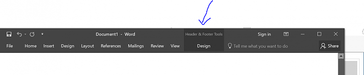

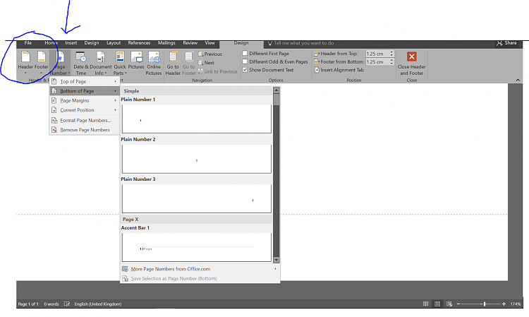

  4. jimbo45 Win User
    Word, Footer, Numbering pages x of y starting from page 3, y is wrong
    Page re-numbering in Word- a real puzzler.
    Hi there
    easy enough
    1) In the document go to Insert Header / Footer
    2) in the drop down click edit footer (or header etc)
    3) you'll see at the top on the document Header and footer tools - click that
    4) now you should see things like page numbers etc -- choose what you want.
    Word, Footer, Numbering pages x of y starting from page 3, y is wrong 111941d1485974426t-page-re-numbering-word-real-puzzler-word1.png
    Word, Footer, Numbering pages x of y starting from page 3, y is wrong 111942d1485974426t-page-re-numbering-word-real-puzzler-word.png
    Note -- save document before starting so if you hose it up you can re-do --always keep a spare copy before messing about with this type of stuff !!!!.
    I'm using Office 2016 but other versions should be similar if not identical.
    Cheers
    jimbo
    jimbo45, Feb 9, 2023
